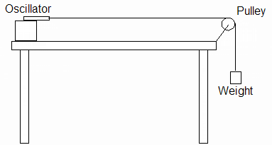

I have one more question, what is your setup? Specifically, is the wavelength fixed or does it change with the length of the string? Your equations imply that the wavelength is fixed. If your setup looks like something like this. the wavelength will be fixed but the total length of the string will increase as the hanging weight increases.

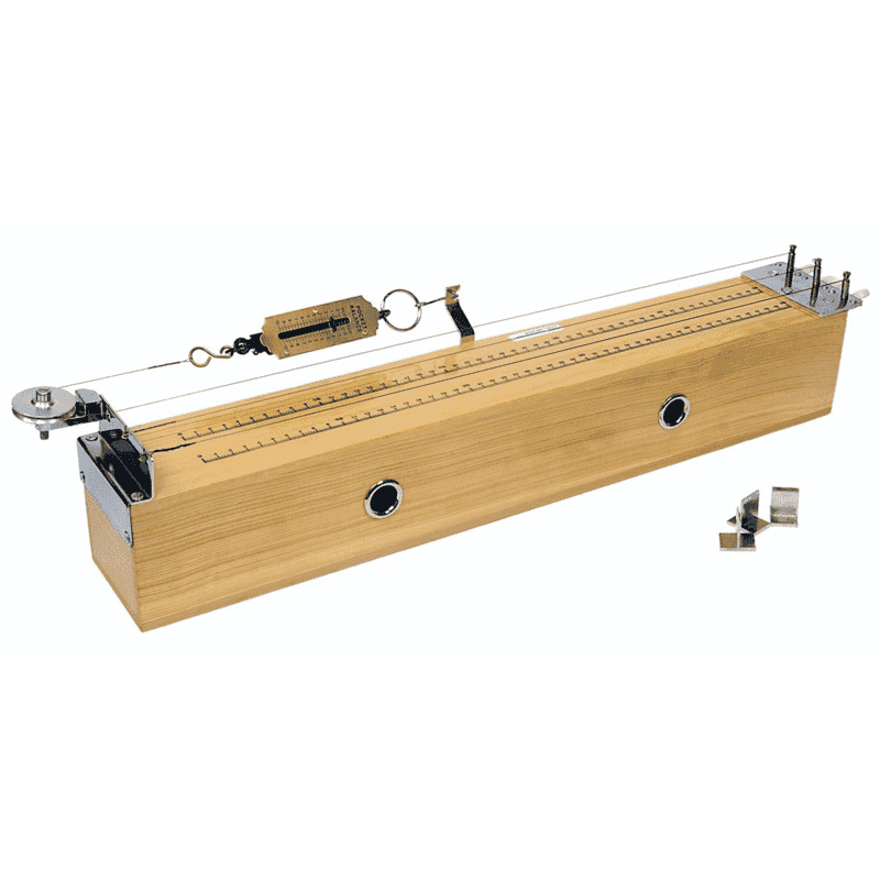

In terms of gathering data for tension and frequency values, I was originally thinking of using a sonometer however the one I have is very short(less than half a meter). Will this affect my data collection and do you have any alternative set up ideas? Thanks.
The short sonometer will not affect your data collection; it will affect the range of data that you can collect, specifically the number of resonant harmonics for a given wire and weight load. Using the right combination of weight load and knife edge separation, you should be able to adjust the fundamental frequency of your stretched wire to the frequency of your tuning fork(s). Derive an expression relating the mass density ##\rho## of the wire to the fundamental frequency, weight load, wire diameter and knife edge separation. These you can measure correspondingly with your sonometer, a micrometer and a meter stick. At this point your sonometer has been converted to a "mass densitometer" that allows you to measure the mass densities of wires of various thicknesses and compositions. Compare your values to the known values and see how good this method is. Don't forget to do error propagation analysis if you know how.

I was thinking of setting up an apparatus like the one I attached below without the weights since I don't have those resources. The apparatus should allow for a change in the tension of the string thereby producing a different fundamental frequency. Also, as the focus of my paper is varying frequency with tension, would varying the length, tension and diameter be unrelated to the goal of the paper? Thanks.

You could maybe find the resonance very exactly if you measure the current into the vibration generator as the frequency is varied. The vibrating string stores energy and creates a dip in current at the resonant frequency. It looks like an electrical resonator, in other words an LC circuit. We see this with loudspeakers very easily. You need to have a series resistor of a few Ohms in the grounded leg, across which you can measure a voltage, maybe with an oscilloscope.
We are doing the string experiment in class at the moment so I will try to do it tomorrow and find out.

Sorry I forgot to specify that I won't be using a vibration generator but rather an apparatus which fixes the violin string to one end and a force sensor on the other. With this set up I can only find tension and frequency values using Vernier and a Phone app however do you have any advice on how I could measure the change in length of the string(as it changes very minimally). Thanks.

I am not sure of your exact equipment layout. Usually the string is held between supports at fixed length, so length does not alter with tension.
We have just done the experiment in school and the pupil measured frequency against length (tension fixed) and tension ( length fixed). Next week we will look at predicting velocity from mass per unit length and tension.
The change in length of the string upon stretching is minimal. You change the length of the string by using a wedge to push up on the string from underneath at some point between the fixed end. Then you end up with two strings under the same tension of lengths ##L_1## and ##L_2## such that their sum is the length of the wire. If you can measure the fundamental of each segment then you can verify that the product ##f_1L_1=f_2L_2=\text{const.}## Next you can move the wedge to a new position and repeat. This result is independent of the tension. If you can measure the tension with a force gauge you can change the tension and repeat. As you may have surmised, the product ##Lf## for the fundamental is half the propagation speed. If you make a plot ##Lf## vs. ##T^2##, you should a straight line the slope of which is related to the linear density (how?).
