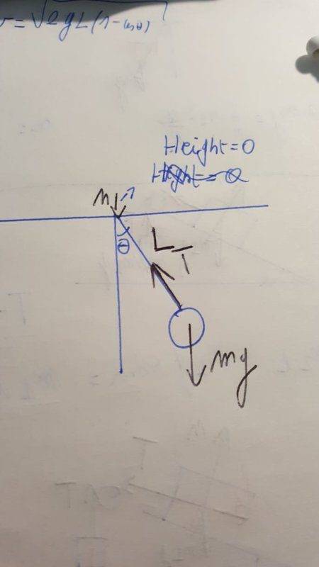

A bowlingball with mass m is hanging on a roof with a wire of length L. The ball is pushed out of equilibrium so that the ball makes an angle θ with the vertical. After letting go it makes a pendulum move. a) Determine the speed of the bowlingball when reaching the equilibrium position. b)Determine the tension of the wire in fuction of L,M and θ.
mgh=1/2*m*v^2
F=m*a
For part a I used conservation of energy.
-m*g*cos(θ)*L+1/2*m*0^2=-m*g*L +1/2*m*v^2 => v = sqrt(2*g*L(1-cos(θ )).
b) For b I was think that T = mg in the equilibrium point but that doesn't invole θ in the answer. So that's why I tought that T*cos(θ ) = mg. So that the tension is mg/cos(θ). But this isn't correct. The answer has to be T = mg*(3-2*cos(theta)).
Thanks for the help in advance. And I apologize for my bad english it isn't my native language.
And here is a homemade sketch of the problem.

Hello snorman,
That would be correct if the ball were not moving. But it is, and the kind of trajectory it describes should help you think of what else ##T## has to do except keeping the ball from accelerating downwards :smile:
Likes snormanlol
Hi bVU,
Thanks for the tip. arad= v^2/L. So that a = 2*g*(1-cos(theta)).
T - mg = 2*m*g*(1-cos(theta)) => T =mg(3-2*cos(theta))
Likes BvU
