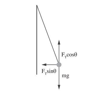

A 0.020-kg mass is attached to a 1.2-m string and moves in a horizontal circle with a constant speed of 1.50 m/s, as shown in the figure. What is the measure of angle θ?
What is given:
  • m = 0.020kg
  • v = 1.50 m/s
  • L = 1.2 m
Lengths
  • L = 1.2m
  • Lsinθ = r
Forces:
  • Tx = Tsinθ = Fc
  • Ty = Tcosθ
  • T = mg/cosθ
What would solve this:
  • atan(Fc/mg) – (Fc needs r)
  • atan(r/h) –(r is unknown, and h would require knowing θ or r)
One (of the many) attempted solutions:
  1. T = mg/cosθ
  2. Fc = Tsinθ
  3. Fc = mg/cosθ * sinθ
  4. Fc = mg*sinθ/cosθ
  5. Fc = mv2/r
  6. mv2/r = mg*sinθ/cosθ
  7. r is unknown, but r = Lsinθ
  8. mv2/Lsinθ = mg*sinθ/cosθ
  9. mv2/L = mg*sin2θ/cosθ
  10. mv2/mgL = sin2θ/cosθ
  11. v2/gL = sin2θ/cosθ
My problem continually being the sin2θ/cosθ, making that not tanθ. If there's something I missed, I feel like it might be some trig identity or sloppy algebra? Nothing came to mind immediately. Every solution path I went, I always ended up needing θ or 'r'. Would really appreciate some help with this one, as I've been consuming too much time with this single scenario. Thank you!

Whoops, that should have been sin^2(θ), and my problem being that it is not tanθ (nor tan^2(θ)), and not allowing me to solve for θ with known values.

What is the most basic trigonometric identity you are aware of?

1 - cos^2 = sin^2 ?
1 - sin^2 = cos^2 ?

Yes. Use this and you will have a second order polynomial in cos theta.
