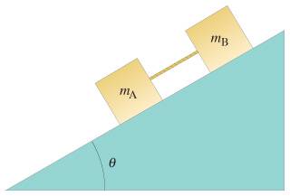

Two blocks made of different materials connected together by a thin cord, slide down a plane ramp inclined at an angle θ to the horizontal as shown in the figure (block B is above block A). The masses of the blocks are mA and mB and the coefficients of friction are μA and μB.
If mA=mB=5.5kg, and μA = 0.19 and μB = 0.30, determine the tension in the cord, for an angle ##θ = 28^{\circ}##
Newton's Laws
My Attempt:After setting up free body diagrams (not shown), I found the acceleration ##a\approx2.5~\frac{m}{s^2}## along with the following equation for T:
$$sin(\theta )mg-T-\mu _acos(\theta)mg=ma$$
$$\Rightarrow T=m(sin(\theta)g-\mu _acos(\theta)g-a)\Rightarrow$$
##T\approx 2.722 ~\textrm{N}## in magnitude
Is this the correct answer?

The solution is correct in principle, but you rounded off the acceleration too much, therefore the second digit of T is inaccurate. You could have canceled a and get T directly.
