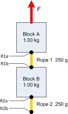

I see now that I didn't label the diagram very well. Here's a better version:
Now, is the net force on point R1a equal to 1000 g x 3.00 m/s^2 + 1500 g x 9.8 m/s^2?
If not, I can't think straight any longer tonight. Off for some sleep.

No, just try to solve question A with
1) ##ma=T-w##
2) ##w=mg##
and I suppose the solution of the questions B-D becomes obvious.

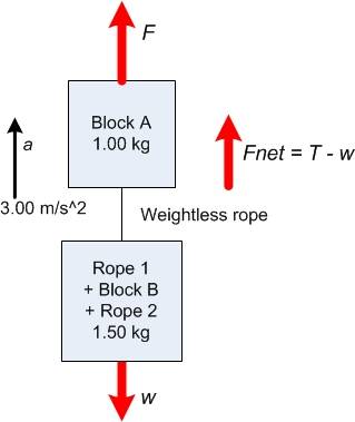

Here's another sketch for part (b), the tension on the top of Rope 1 (point R1a).
Fnet
= T - w = ma = 2.5kg x a = T - 1.5kg x g
T
- 1.5kg x 9.8m/s^2 = 2.5kg x 3m/s
T = 2.5kg x 3m/s + 1.5kg x 9.8m/s^2
T = 7.5N + 14.7N = 22.2N

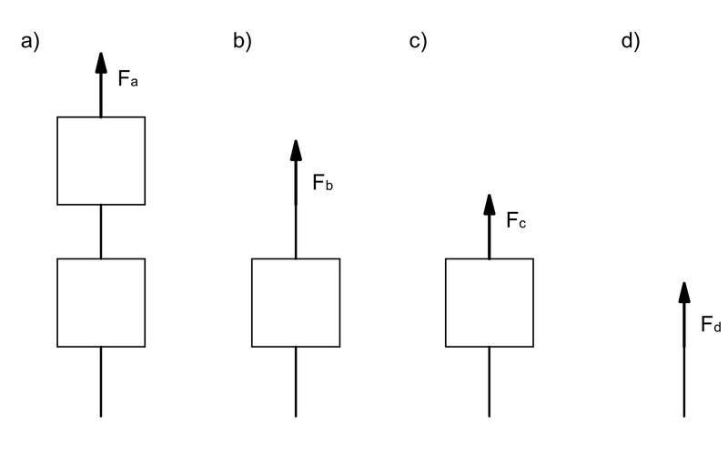

I'm sorry for the confusion regarding the expression "point". Try to mentally cut the system at the respective spot (as I drew for the four questions in the picture at the and of the post). The corresponding forces ##F_a## to ##F_d## act to accelerate all the masses below. Let's start with a) and solve the force balance for it.
##ma=F_a- \sum m_i g##
Now all the other questions b)-d) can be solved analogously. From the drawing you can see, what masses the forces ##F_b## to ##F_d## have to accelerate.

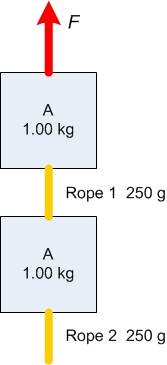

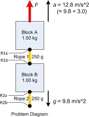

Good. Here's an updated problem diagram and FBD for the entire system:
Do you see any errors here?

Well, according to your right picture the force balance yields ##ma=F-F_g=32-24.5=7.5\;N##. The mass ##m=2.5\;kg##, therefore ##a=7.5\;N / 2.5\;kg = 3\;m/s^2##. That's the requested value for the acceleration and the answer of the question a) is obtained (##F_a=32\;N##). So I don't see an error.

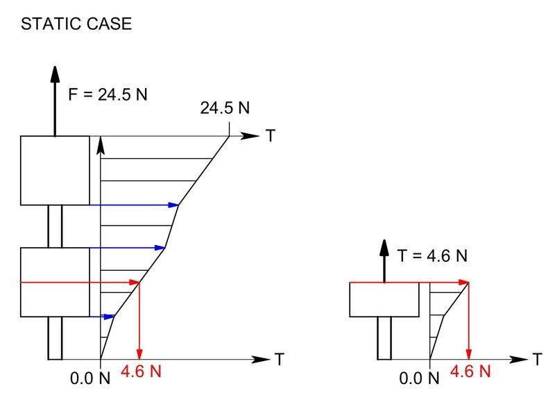

Imagine the system in rest (no change of the state of movement (so ##a=0##, static case). Now at the very end of the second rope, the tension force is zero, since below that point there is no mass to hold. Assuming homogeneous bodies and mentally going upwards from the bottommost point (as illustrated in the picture below the post): The tension in the system must increase linearly and at the connections between boxes and ropes there must be a discrete change of the slope (blue arrows). At the top the force holding the entire system must be equal to the weight force. If you want to find the tension force at a certain position, you can find it using the tension force progress (example: red arrows to find the tension force of 4.6 N somewhere in the lower box). The 4.6 N correspond to the weight force of the masses below.
Now, the entire system is accelerated. Like the tension force only has to hold the weight of the masses below in the static case, it only has to accelerate the masses below in the dynamic. If the entire force ##F## would be applied to the partial system, the acceleration would be higher than at the top and the top part would be overtaken by the lower parts of the system. The difference ##F-T## is used to accelerate the masses above.

Your diagram is very helpful. I think I understand all of it except for the tension of 4.6N at what looks like the midpoint of Block B. I have annotated your drawing to add scales for mass and tension.
Did I do the T calculations correctly? If so, then it seems that your 4.6N should be 7.35N. No?
Edit: I keep making typos. I just corrected the last line in this post to say 7.35N, not 2.45N.
In the previous post, I transposed the digits in F and labeled it 23N, when I meant 32N. (sigh)

Please let me know if there are any errors.
Now, to get to the dynamic case, all I have to do is add the 3.00 m/s2 acceleration force. Here's that table.
I don't have a diagram for that yet.
Please let me know if any errors.
Thanks
Sorry, that was my bad. You are of course right, the force should be around 7.4 N. Thanks for noticing.
