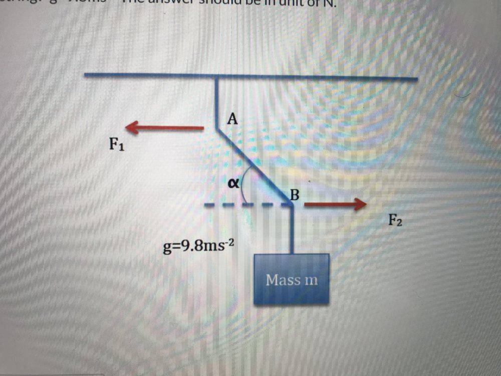

A block of mass is suspended from the ceiling by a string as shown in the figure below. Two forces F1 and F2 cause the string to bend as shown in the figure. The section AB of the string makes an angle of α=43.5 degree with the horizontal line. The mass of the block is m=46.9kg. What is the tension of section AB of the string? g=9.8ms-2 The answer should be in unit of N.
f=ma
I am new to physics
I have no idea how the forces work and how to calculate the tension with f=ma
thank you very much..
First of all, what is the acceleration of the system?
If you understand resolving forces in different directions or finding the horizontal and vertical component of a force, that will help.
Then you can consider the forces at A or B and look just at the vertical or just at the horizontal forces.

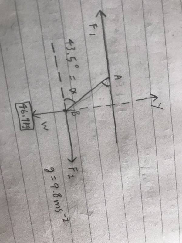

Have you been taught to draw free body diagrams? Draw one for point B. Consider the balance of forces.
like this?

Right, so what equations do you get for the balance of forces acting at B? Which of them gives you the tension?

We are only looking at forces acting at B, so F1 is not relevant.
There are, in principle, two directions to consider at B. You can choise any two, but here it will be simplest to consider horizontal and vertical. You can write an equation (∑F=ma) for each, though you might not need both.
In these questions you seem to be confused about what a means in F=ma. It means the acceleration which is happening; if the system is static the acceleration is zero.

is the answer 667.7082?
I first calculated the tension of the weight: 46.9x9.8=459.6
then I used 459.6/sin43.5to calculate the tension of ab
is this correct?
is this correct?
Looks right. But where the answer is the result of multiplying and dividing a bunch of inputs, you should not quote more significant figures in the answer than in the input number with the fewest. So 668N is a better answer,

So you looked at point B and considered just the vertical forces
getting W=T sin 43.5
Once you know the tension, if you consider only horizontal forces you get your result for F2.
Why do you not need a calculation to find F1 ?
