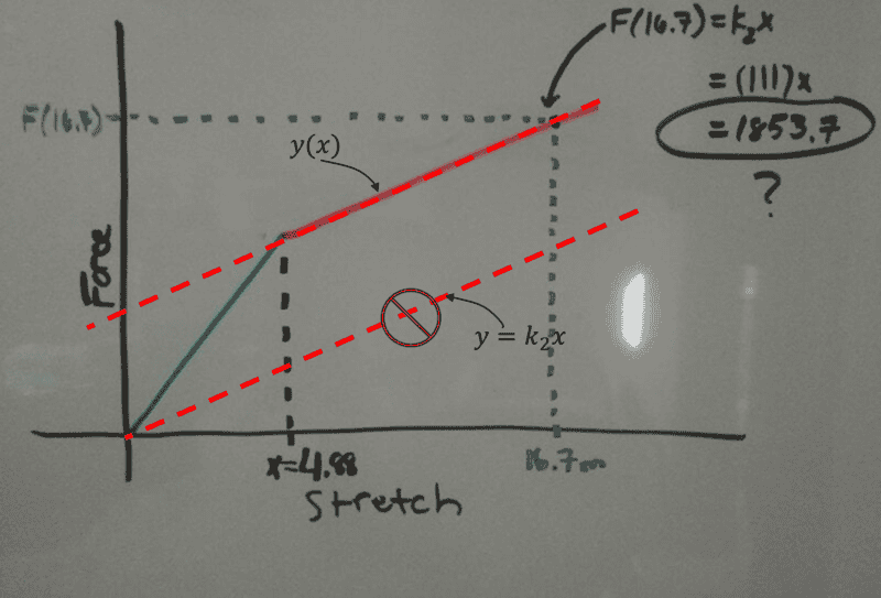

A bungee cord is essentially a very long rubber band that can stretch up to four times its unstretched length. However, its spring constant varies over its stretch. Take the length of the cord to be along the x-direction and define the stretch x as the length of the cord l minus its un-stretched length l_0. Suppose a particular bungee cord has a spring constant, for 0 <= x <= 4.88, of k_1 = 204 N/m and for x > 4.88, of k_2 = 111 N/m (Recall that the spring constant is the slope of the force F(x) versus its stretch x.) (a) What is the tension in the cord when the stretch is 16.7 m (the maximum desired for a given jump)?
F(x) = kx
(a)
x = 16.7
Since x > 4.88, k = k_2 = 111 N/m.
T = F(16.7) = k_2*x = 111*16.7 = 1853.7 N
The answer key says the correct tension is 2320 N. Any help is appreciated, I'm not seeing where my math is wrong.

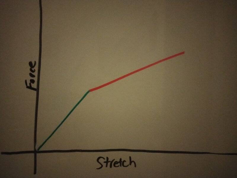

If the constant is k at some point, stretching it by a further distance x requires an additional force kx.
Sketching a graph might help.
I'm having trouble understanding. So the total tension at a stretch, x > 4.88, is not given by F(x) = k_2*x? I can't see where the extra tension comes from.
Right, it is given by ##\Delta F=k_2\Delta x##.
What is the tension at 4.88m? What is it at 4.89m? It can't be less, right?

But furthermore the force must be continuous. If it were ##k_1 x## in the first region and ##k_2x## in the second, what would happen to the force at the boundary between regions?Also note that the hint can be written ##F’(x) = k## if you are familiar with calculus.

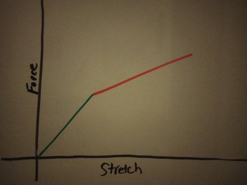

So draw a line which starts at the origin and has exactly two positive slopes, the first greater than the second. Note, no other slopes, not even vertical.
Since the y axis is force and the x axis is displacement, the area under it out to a displacement x is the work done to stretch it that far.

But if it's asking for tension then I need to find to force (N) of the spring, correct? I'm not sure how work factors in.

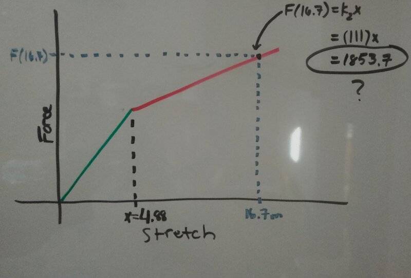

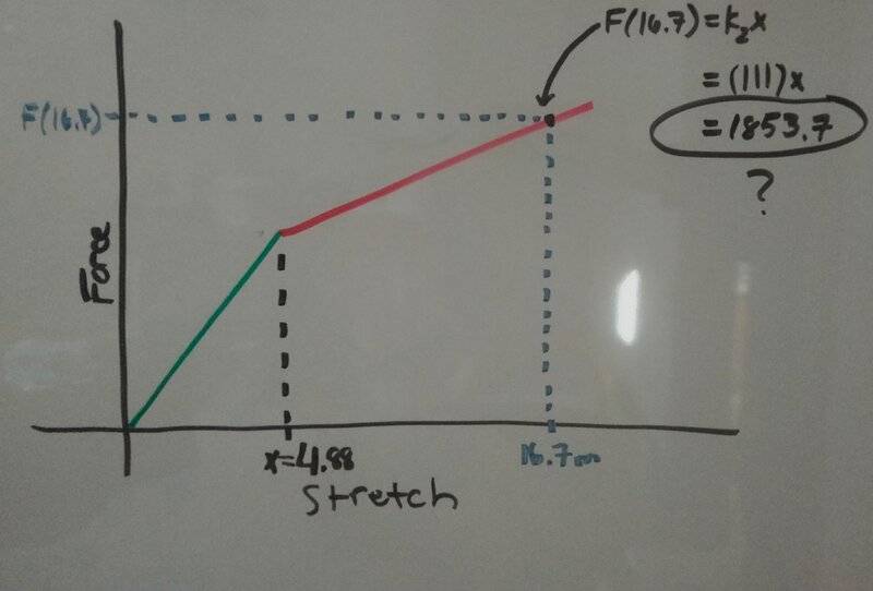

Now put a vertical line marking a stretch of 4.88 m(for clarity), and then one marking the total stretch of 16.7 m. What is the value of ##F## at 16.7 m?
So this is incorrect?
Its the correct graph, but your calculation is incorrect.
Can you write the equation of the line beyond ##x = 4.88 \rm{m}##?
What is ##y(x)##

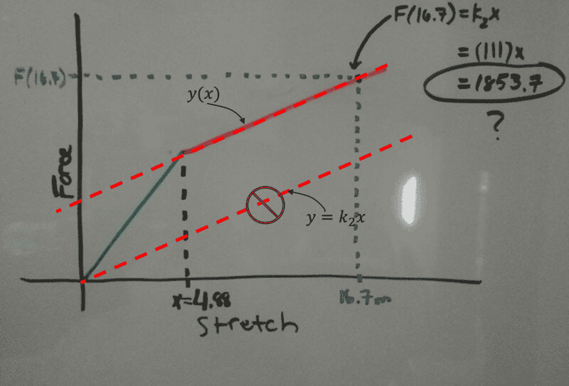

If Hooke's Law applies to bungee cord then the force is F(x) = kx, and in this particular case k=k_2=111? I seem to be going in circles and not sure where I'm going wrong. Is the force supposed to be a negative value?

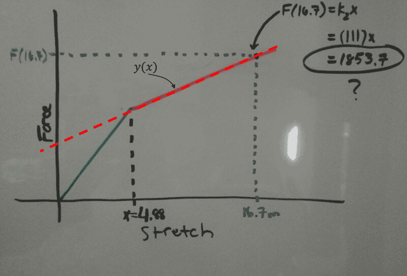

You are evaluating the value at ##x = 16.7## m incorrectly.
The equation of the red dashed line in the graph beyond 4.88 m is not ## y= k_2 x##
There is a discontinuity in the spring constant. It's not really a "Hookean Spring" to the letter of that definition. You are saying the red dashed line passes through the origin, it clearly doesn't.
Likes I_Try_Math, Delta2 and jbriggs444
You're exactly right. That was confusing. Just got used to that formula always being in the form k*x I guess. Math isn't my strong suit but thanks a bunch for your help.

It's not your math so much. The definitions can be subtle. The spring behaves in linear manner over each range, which makes one think "Hooks Law". However, the spring "constant" of this spring is not constant- i.e. not "Hooks Law".
