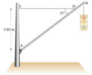

An 11 kg traffic light hangs fro ma structure as shown.
The aluminium pole AB is 7.5 m long, and weighs 8 kg. Determine the tension in cord CD
T = rf[/B]
Ignore the AC height of 3.8 m, and replace it with an AD length of 7.5 m.
Would the pivot point be A or D?
If D, how would I find the r for D to B?
For the equation ΣT = r1f1 + r2f2 + r3f3, with r1f1 being the pole, r2f2 being traffic light, what would the cale be as?
I understand how to do the calculations, but looking at this I'm not entirely sure on how to get the F for the cable.
I know that it'll be either sin or cos 37 to take into account the angle, but I'm lost.

Scatteredheroes said:
Ignore the AC height of 3.8 m, and replace it with an AD length of 7.5 m. That's not ignoring, that's using. However, I don't agree with the answer !
Would the pivot point be A or D? If the cable breaks, it's A :smile:; for calculations you can use either, but which would be simpler ?
If D, how would I find the r for D to B? Same way you found AD: with a little trig. Or subtract AD from 8 m ...:rolleyes:
For the equation ΣT = r1f1 + r2f2 + r3f3, with r1f1 being the pole, r2f2 being traffic light, what would the cable be as? How about r3f3 (in your notation)
[edit] hint: draw a few forces such as ##\ m_{\rm \, pole}g## , ##\ m_{\rm \, light}g## , cable tension in your diagram...

Why is the distance AC being ignored?
Ask yourself, what member is in equilibrium here? What would you show in a free body diagram for this problem?
Looks like you're stuck if you picked D. And ignored AC.
It's not clear what you are doing here. What is the reference for writing ΣT?
There are two equations of equilibrium you must write: Σ F = 0 and Σ M = 0

So, which has a length of 7.5 m, the aluminum pole AB or the length AD?
When you say that ##r_1F_1## is the pole, what do you mean?
Do you think the change your teacher made was to make the points D and B coincide?
AB is the 7.5 m.
And r1(f1) is the pole being (8)(9.81)cos37 (8 is mass of pole) and r is the distance from the center of mass to the pivot.

I'm not sure you can ignore the distance AC and still solve this problem, at least not without knowing where point D is located.

There are no lengths in the attached image. In the OP you said to take AD as 7.5m, so is AB still 7.5m or is it more? If it's more, we need some way to find how much more.
Sorry; I didn't proof read before I posted.
AB is 7.5 m.
We are given the weight of the pole, the stoplight, the angle of 37 degrees, the length of AB and that is all.
AB is the 7.5 m.
And AD is also 7.5 m?
We don't know AD.
We don't know AD.
Then there is still not enough information. You need to know both.
The exact question is: An 11kg traffic light hangs from a structure as shown. The aluminium pole AB is 7.5m long and weighs 8 kg. Determine the tension in cable CD.
He told us the angle CDA is 37.
Are we still ignoring the AC height of 3.80 m? If so, then you have misunderstood what your teacher told you to do. I suggest you start over with just a statement of the problem you want us to help you solve, along with a single diagram that contains the correct information.

You say 'as shown', but the diagram attached looks like it might have been something you drew. Does it accurately represent the diagram given to you?
My suspicion is that B and D are now the same point.
"An 11 kg traffic light hangs from a structure as shown. The uniform aluminium pole AB is 7.5 m long and weighs 8kg. Determine the tension in the cable CD"

Can't be solved as stated. I suggest you make a new drawing with the points B and D coinciding. Then try to solve that.
So; even with the picture our teacher gave us, it is unsolvable?
See Post #20.

In the photo you attached, there is a pencilled line redirecting the point of attachment of the cable to be at B. I assume you drew that, which suggests that at some time you understood that points B and D should now be taken as the same point. AB=AD=7.5m
Oh, no, that was just me trying to figure out the angle. He said nothing about B and D being the same point.
So who invented the 37 degrees ? Is the picture complete ? I can't read the entire problem statement ! ?:)
Was he the one who said to ignore the AC length of 3.8 m, or was that you?
Him.
He also told us to add the 37 degrees because he forgot to add it onto the photo; and I've typed the statement up to a T.
Him.
That gives me even more confidence that you should follow the advice I gave you in Post #20.
