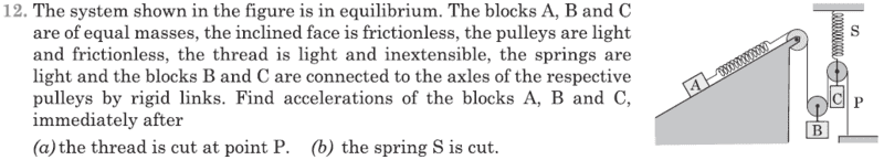

See attachment.
In equilibrium position, the pulley that holds mass C (we will call this pulley C later on) is pulled upwards by spring S . Hence, the string around the pulley C becomes tense. Now, if spring S is cut, my intuition says that the tension around this pulley will become zero, and mass C will undergo free fall. But, the book says the acceleration is 2g. I assume that it is because the tension is still there, but how is this possible?
Why do you think it would not be possible? It is the basic functioning mechanism behind a slingshot.

Oh! So, we assume the string as the rubber in slingshot, but with a huge hooke's constant. When the whole system is at equilibrium , the string will be stretched infinitely small. After the spring is cut, it will return to its normal state, hence still exerts the tension. Am I correct?
No. The string is inextensible. The principle is the same due to the other spring.
I'm at a loss here. Could you please explain the relationship between that spring and the string tension?
Likes Delta2
The tension in the string is not going to go away just because you cut the other spring. You have to actually compute the tension. Generally the tension is going to result in the mass attached to the cut spring being accelerated more than g downwards.
If you draw a free body diagram of the system, with and without the force from S, you will see that forces are helping the pulley-mass C to fall faster than it would in free fall.

Hm. Does the tension on pulley C still there at time ##t## after the spring is cut?
Let me give a little explanation about why I think the tension is zero.
At the instant after the cut, The string will not in contact with pulley C.

I agree there is a flaw here. The problem is the connection between pulley C and mass C. It is shown as possibly a string. If so, cutting S will result in an arbitrarily large acceleration of pulley C and mass C going into free fall.
So take that connection to be a rigid rod. That makes the pulley and the mass effectively one object. Its inertia means the string over pulley C will not immediately go slack.
Does the book give the answers for the accelerations of blocks A and B immediately after the spring is cut?
Both are 0

How could the system be in static equilibrium if the masses of blocks A and B are equal, and the slope is frictionless?

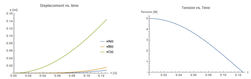

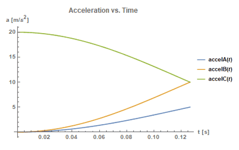

Setting up and solving the equations of motion for the three masses is not too hard unless I’m overlooking something. Then we can look at how long it takes for the string to go slack after spring S is cut.
Positive direction for A is down the incline and positive directions for B and C are vertically downward. I find that if spring S is cut at time ##t = 0##, the accelerations of the blocks as functions of time turn out to be the following: $$a_A = \frac{4}{9} g \left[ 1-\cos(3 \omega t) \right]$$ $$a_B = 2a_A = \frac{8}{9} g \left[ 1-\cos(3 \omega t) \right]$$ $$a_C = 2g-a_B = \frac{1}{9} g \left[10 + 8 \cos(3 \omega t) \right]$$ Here, ##\omega \equiv \sqrt{k/m}##, where ##k## is the spring constant of the spring attached to A and ##m## is the mass of each block. Once the string goes slack these equations no longer apply.
The tension in the string becomes zero when ##a_B = a_C = g## and ##a_A = g/2##. This occurs at the time $$t_{slack} = \frac{\arccos(- 1/8)}{3 \omega} \approx 0.565\sqrt{\frac{m}{k}}$$
As an example, if I choose ##g = 10## m/s2, ##m = 1## kg and ##k = 20## N/m, then ##t_{slack} \approx 0.126## s. For this example, I get the following graphs for the accelerations of the blocks up until the string becomes slack:
Here are graphs of the displacements of the blocks from their equilibrium positions and a graph of the tension in the string as functions of time:
By the time the string becomes slack, block C has moved about 14.4 cm while blocks A and B have moved only about 1.5 cm and 0.8 cm, respectively.
