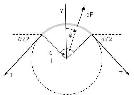

A small circular flexible loop of wire of radius R carries a current I. It is placed in a uniform magnetic field B. The tension in the loop will be double if
A) I is doubled B) B is halved C) r is doubled D) both B and I are doubled.
(Assuming B to be inside plane of paper and I to be clockwise)

What is the relevant equation showing where the tension comes from?
I think F=I(lxB) where l will be 2*pi*r?
No. Consider first an element dl = r dθ and the force acting on it at each of its ends.
Will the force acting on the dl element not be radially outwards?
It will indeed be radially outwards, but the rest of the loop will keep it in place by exerting tension at its ends. Draw a FBD.

Ah.. I got mixed up with that. Ok. So the element dl will remain at it's place meaning net force on it is zero? So, the net outward force = I(dlxB) will be balanced by the two forces at it's ends. Btw how will we do it?
kuruman said:
According to the problem, the wire is flexible not elastic and its radius is fixed at R. I don't interpret this as meaning that the loop can stretch. All it means is that it wll assume a circular shape of radius R.
I think the force acting radially outwards on the element dl will be I(dlxB) which is IdlB as dl is perpendicular to B. This force will be balanced by sin of both the tension forces. Also, their cosines will cancel each other.
So we will have an equation IdlB=2Tsin(dx), where T is the tensional force and dx is the angle which each tension vector makes with the tangent at dl (dx is d(theta)). As dx is small, sin(dx)=dx.
So equation becomes IdlB=2Tdx
Giving T=IdlB/2dx.
dl/dx can be written as r where r is the radius.
So, T=IBr/2.

It looks like your tension is half of what it ought to be. Here is the FBD. You need to balance forces in the y-direction. Remember to integrate the y-component of dF using integration variable φ.

Ok.. so I took the angle that T vector makes incorrectly. It should be dx/2.
Can you finish now?
I am a little unsure about this but, I wrote this as
dFcosφ=Tθ (i wrote sinθ=θ) and then wrote dF as IdlB where dl is rdφ and integrated it from -θ/2 to θ/2 and wrote sinθ/2=θ/2 and finally got
IBr=T.
Is this correct?

That's what I got.
cheapstrike said:
If this is, then shouldn't the answer be A) and C)?
I would say the answer is A or C. Are you sure this is not a multiple answer question?
