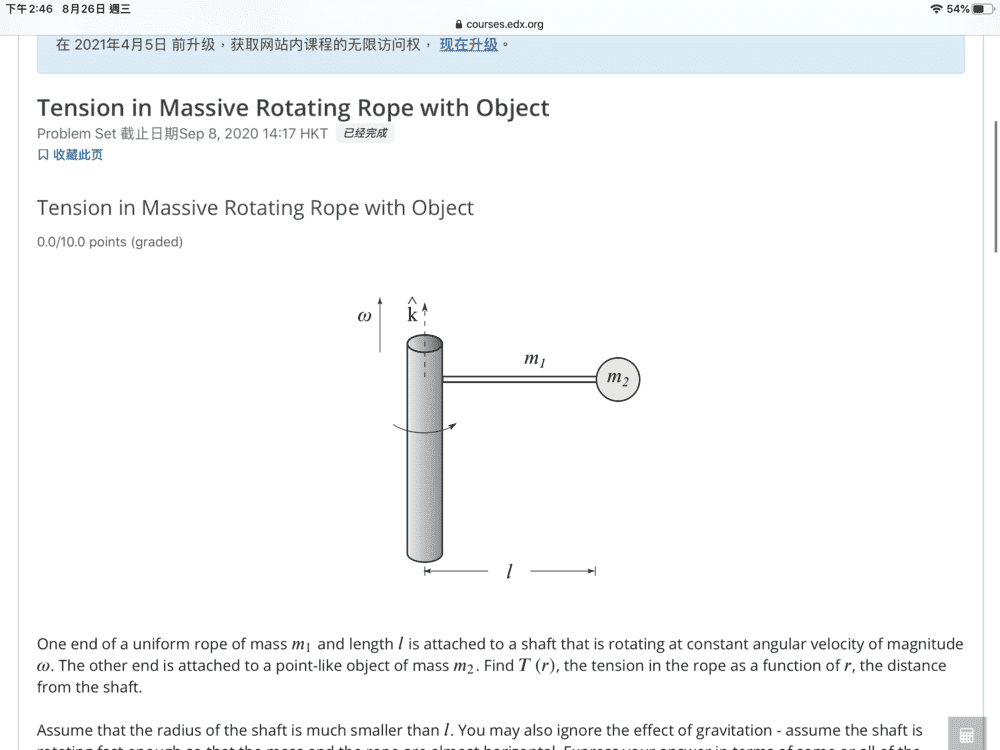

The question is comes from MIT.
The equation are 𝑇(π‘Ÿ+Ξ”π‘Ÿ)βˆ’π‘‡(π‘Ÿ)=Ξ”π‘šπ‘Žπ‘Ÿ, find T(r).
The whole question is:
One end of a uniform rope of mass π‘š1 and length 𝑙 is attached to a shaft that is rotating at constant angular velocity of magnitude πœ”. The other end is attached to a point-like object of mass π‘š2. Find 𝑇(π‘Ÿ), the tension in the rope as a function of π‘Ÿ, the distance from the shaft.
Assume that the radius of the shaft is much smaller than 𝑙. You may also ignore the effect of gravitation - assume the shaft is rotating fast enough so that the mass and the rope are almost horizontal. Express your answer in terms of some or all of the following variables: m_1 for π‘š1, m_2 for π‘š2, omega for πœ”, π‘Ÿ and 𝑙.
I can β€˜t find the picture only website, you can find the picture at
https://ocw.mit.edu/courses/physics/8-01sc-classical-mechanics-fall-2016/week-4-drag-forces-constraints-and-continuous-systems/problem-set-4/
My misunderstanding is the difference between l and r and the relationship in the question .

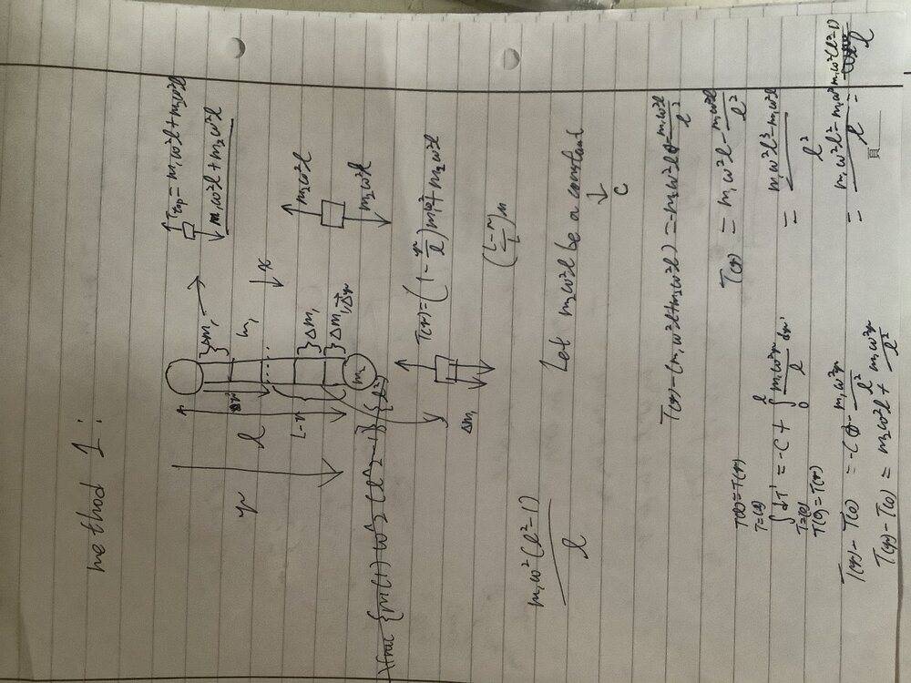

π‘ŸΜ‚ :𝑇(π‘Ÿ+Ξ”π‘Ÿ)βˆ’π‘‡(π‘Ÿ)=Ξ”π‘šπ‘Žπ‘Ÿ where π‘Žπ‘Ÿ is the radial acceleration, π‘Žπ‘Ÿ=βˆ’πœ”^2π‘Ÿ . Using that Ξ”π‘š=π‘š_1/(l)Ξ”π‘Ÿ , the equation above becomes: 𝑇(π‘Ÿ+Ξ”π‘Ÿ)βˆ’π‘‡(π‘Ÿ)=βˆ’Ξ”π‘šπ‘š_1*π‘™πœ”^2π‘Ÿ. The equation set up byΞ”π‘š=π‘š_1/(l)Ξ”π‘Ÿ is from the tension formula. However this is the point where I don’t understand.I had separate T(r) into T_1 and T_2 , but I don’t know what is the next step?

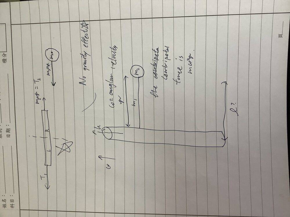

ok, now I need to to consider two system , one is the m_1 and second is the m_2 , and I divided the tension acting on them by -T_1 and T_2, and the T_2 should be m_2*omega^2*l because the centripetal force should be m*omega^2*(radius) in this case, so ,what is the next step, I start feel confused.I am confused about the Tension acting by m_2 is how to work as and the inward tension work as.It is
-m_1*omega^2*r+m_2*a*r+m_2*omega^2*r...I think it is a little bit complicated, I can’t put my concept together.

Using those corrections, see if you can write the differential equation. You will also need to understand that by definition ##T(r+dr)-T(r)=dT##.
I got T(r)=(m_2*omega^2*L+m_1*omega^2*r)-T(0)
but the thing is , I canβ€˜t really define T(0), which it hold all outward force acting on the m_1 and m_2 , so, can you help me to define T(0), because it feels complicated to me, it maybe (m_1+m_2)*omega^2*r, I β€˜m not sure, can you tell me how to find the T(0), I know the T(0) is the force that against all outward force, but my calculations will only become 0 after that.

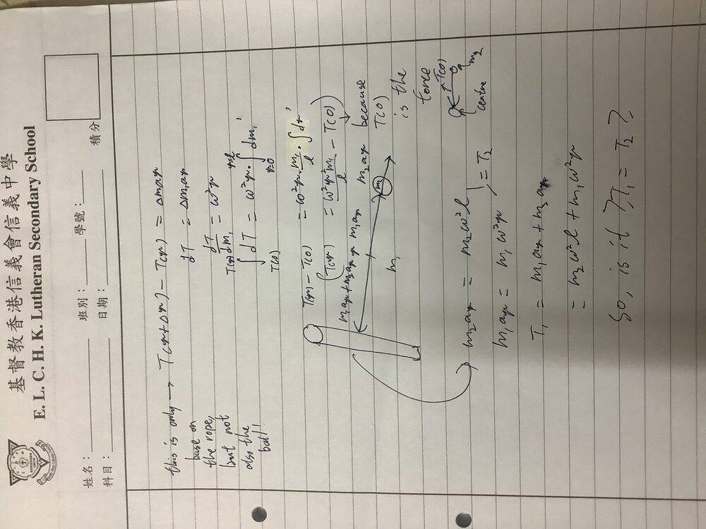

But this is correct ? 𝑇(π‘Ÿ+Ξ”π‘Ÿ)βˆ’π‘‡(π‘Ÿ)=Ξ”π‘š*a*r, I am getting confused on the relation
between T(0) and T(r), is it the x-direction acceleration should be 0?Is it T(0)-T(r)=0?
This is what I am confused the most.
π‘Žπ‘Ÿ
Because of object two, I am confusing about how to put the tension affect by the object to combine the tension on the rope.It is the tension at r=L is m_2*omega^2*L?
What I am wrong? Does there any hint for T(0), because T(L)is m_2*omega^2*L, but ... how about T(0) , I still can’t understand how to find it, as I don’t know is the relation of T(r), that it should not be 0.

View attachment 268416π‘Žπ‘Ÿ
You have ##dT=\omega^2r.dm_1##, which you turned into an integral as ##T(r)-T(0)=\int_0^r\omega^2r.dm_1##. That is not really a valid way to write it. The variable of integration is the thing after the 'd', so in your integral it is ##m_1##, but the bounds should refer to that variable, whereas your bounds refer to r.
You then wrote it as ##\omega^2r\int.dm_1##, but ##dm_1=\rho.dr##, where ##\rho## is the linear density of the rope. You cannot move outside the integral terms which vary through the integral.
You need to solve ##T(r)-T(0)=\int_0^r\omega^2r\rho .dr##

I got ## { m_1 \omega^2 {( l^2 - 1)} / {l}} ## = T(r)
It is I should add back ## m_2 \omega^2 l ## ?
I had use two different method result two different answer, but I think there are some mistake, but I am still a beginner of calculus, so can you tell me where I state wrong?
Second answer: ## {{ 1 - r / l } * {m_1 \omega^2}} + m_2 \omega^2 l##
I find myself typing in something wrong, this time is the correct one.

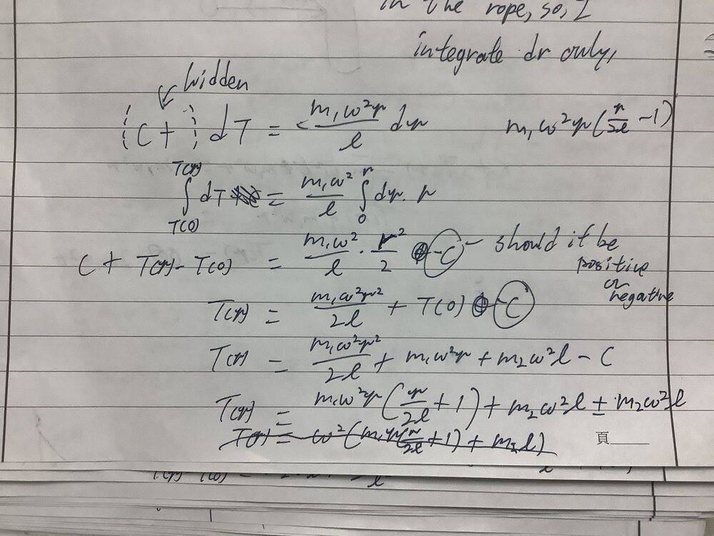

Is it I should do like this?
MichaelTam said:
Is it I should do like this?View attachment 268456
Better, but you are ignoring what I told you in post #20.
If you have an integral equation ##\int_{t_0}^{t}dt=\int _{r_0}^{r}2r.dr## you can write ##\Delta t=\Delta r^2## or ##t-t_0=r^2-r_0^2## or ##t=r^2+c##. You do not need to write ##\Delta t=\Delta r^2+c##.
In the ##t=r^2+c## form, you can substitute the boundary values to get ##t_0=r_0^2+c## to find that ##c=t_0-r_0^2##, so ##t=r^2+t_0-r_0^2##, exactly the same as with the other forms.
