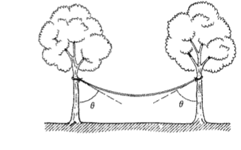

A uniform rope of weight ##W## hangs between two trees. The ends of the rope are same height, and they each make an angle ##\theta## with the trees. Find :
a): The tension at the either end of the rope.
b): The tension in the middle of the rope.
[/B]
For the tension at the end, We split the tension in horizontal and vertical compoenents. ##T \sin\theta## and ##T \cos \theta## respectively.
Since the vertical forces balance the weight, ##2T \cos\theta = W \iff T = \dfrac{W}{2\cos\theta}##,

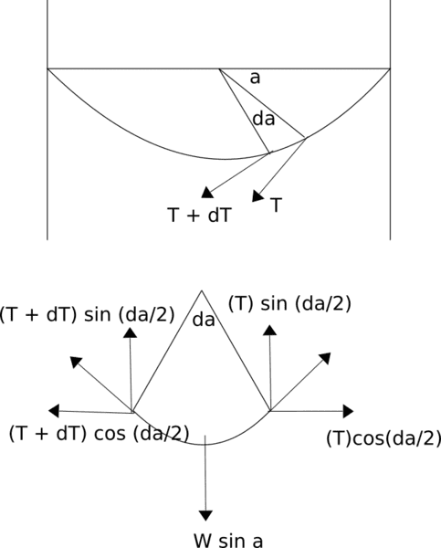

I know the tension would be tangent to the curve. I thought I will integrate over the curve to find the total tension but the curve is not a semi circle instead it is a catenary which has a locus ##y = \alpha \cosh(x/\alpha)##, nevertheless this locus looks a complete mess to.
Is there a way apart from this mess ?
If you draw a free body diagram of an arbitrary section of the rope, what is the total horizontal force component?
Ok let me try.
So the total horizontal force would be ##dT \cos(da/2) \cos a## is this correct ? Now should I integrate from ##0 \to \pi/2## ?
It is much (much) simpler than that. You just need to draw the free-body diagram of the correct part of the rope. Hint: Try drawing the free-body diagram for half the rope. What forces act on that half in the different directions?
Ok I did that, the horizontal force toward right is ##T\sin \theta## and towards left is ##T^\prime##, since rope is at rest, ##T^\prime = T\sin \theta = W\tan\theta /2##.
Is this correct ?
As you move along the rope, how would you expect the vertical component of tension to change? How would you expect horizontal component to change along the rope?
Is this correct ?
Yes.
