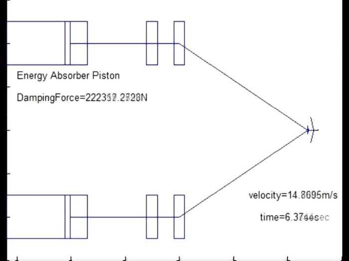

You should draw a sketch of the plane and the arrester cable (that's what it's actually called) looking down on the deck of the carrier. You've assumed in your calculations that there is only one tension you are dealing with. The arrester cable system is actually arranged more like this:
Note: Ignore the numbers on the graphic. They are not for this problem.
In the graphic above, the plane has snagged the arrester cable and is moving to the right.

You don't have to worry how the tension in the arrester cable is maintained, only that it remains constant while slowing the aircraft.
This image was the best one I could find online which showed how the arresting system worked for purposes of illustrating the current problem.

I think I may have only solved for half of the tension
Yes, it looks like you forgot there are two instances of the tension, as far as the aircraft is concerned.
You don't need any calculus to solve this. Just think about the work done on the cable.
