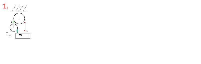

Give the correct tension, T, in the marked rope for each situation. The rope is held so the system is stationary. All ropes and pulleys are massless and frictionless.

1) I figure that the two pulleys holding the weight W each have a tension of W/2, making the first B) T = W/2
2) The three pulleys holding the weight W each have a tension W/3, and the pulley holding the two pulleys connected to the weight must have a tension of 2W/3, making the second F) T = 2W/3
3) The three pulleys holding weight 2W each have a tension 2W/3, and the pulley ropes holding those pulleys each have a tension of 2W/3, divided by 2 = 2W/6 = W/3. This makes T = W/3
4) I'm not quite sure how to do this one
Thanks for your help!

Instead of the guessing game,first understand the concepts ,and take one step at a time.Get in the habit of making Free Body Diagram(FBD). Consider the two pulleys separately ,identify and clearly draw all the forces acting on them.
Remember tension in a massless string is same throughout its length.
Look at the figure I have attached.Consider the lower left pulley.
The forces acting on it are tension(2-green upwards),T downwards and tension (1-Blue downwards).
The tension throughout the string over the pulley is same .Since the force exerted on the left part of the string is T ,the tension in the right part(1-Blue) is also T .Next consider the top pulley.The tension in the left part of the string(2-green) should be 2T .Why?
Because since the lower left pulley is massless ,the net force on it should be zero.It is being pulled down by a force 2T(T downwards from left end and T downwards from right end) .So tension in the left part of the string((2-green) should be 2T.
This 2T gets transmitted throughout the string over the top pulley .So tension on the right part of the string (3-Red)over the top pulley is 2T .
Now can you figure out what is the upward force on weight W ?

So the upward force on weight W for #1 would be 3T?
Yes...
Likes 1 person
Then in 2), would the upward force on weight also be 3T? from the T/2 + T/2 on the small pulleys, then +2T from the long rope on the far right?
Yes...Very Good :)
