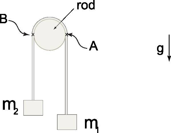

I solved the first part of the problem correctly. Here there is the second part:
assume that m1 is large enough so that the rope starts to slip and the masses start to move. What is a, the magnitude of the acceleration of the masses after sliding has begun?
Hint: Just when the masses start moving, the relationship between T_A
and T_B becomes T_B=T_A*e^(-mu_k*pi), where mu static is replaced by mu kinetic.
m_1>m_2
theta = pi
I guess I have include the friction force and use the Capstan equation to do so but I am lost.
T_1>T_2
T_1 = T_A (from the first part)
T_1 = T_2 + F_f (friction on the contact surface)
m_1*g-T_A=m_1*a_1
T_B-m_2*g = m_2*a_2
I tried to experiment with the moment of inertia but it wasn't covered in the course. Any hint what to do next? I am still left with T_A, when I try to calculate acceleration.
I don't see how. You know the relationship between TA and TB, and the relationship between a1 and a2. Four equations, four unknowns.

Is this correct:
for T_A:
m_1*g-T_A=T_A*e^(-mu_k*pi)-m_2*g
since m_1*a_1=m_2*a_2
finally I got:
T_A=(g*m_1+m_2)/(1+e^(-mu_k*pi))a*(m_1+m_2)= m_1*a_1-m_2*a_2
The right side:
T_A-m_1*g-T_B+m_2*g = T_A*(1-e^(-mu_k*pi))+g*(m_2-m_1)
So
a = ((g*(m_1+m_2)/(1+e^(-mu_k*pi)))*(1-e^(-mu_k*pi))+g*(m_2-m_1))/(m_1+m_2)
It looks complicated.
Um, why?
Likes Poetria
haruspex said:
Um, why?
I thought this is because mass 1 and mass 2 are connected.
Yes, but by what, exactly?
Likes Poetria
By a rope of course. I thought net force for 1 should be equal in magnitude to net force for 2. I guess I don't understand it. :(
Right, not a length of elastic.
Yes, It won't stretch. It is just like taking derivatives of the length of a rope. Acceleration is its second derivative.
So is just a_1=a_2?
So is just a_1=a_2?
Right.
Likes Poetria
haruspex said:
Right.
Thanks. I got the right answer. Phew.
haruspex said:
Right.
It should be (a_1 = - a_2). Correct me if i am wrong.
If you look at the equations in post #1 you will see that a1 is being defined as positive down while a2 is defined as positive up. a1=a2.
yes, i missed that, thank you.
