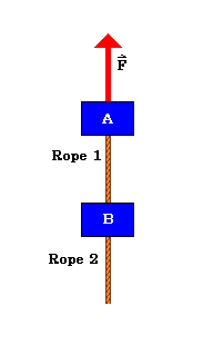

Hi, I am currently enrolled in a first year Physics for Scientists and Engineers course at a university, but I am a biochemistry student without a physics background. I am relatively certain that the problem is a forces problem, but there is a chance that it could be energy as we have just begun studying that. I am not sure how to calculate tensions over a non-constant system, particularly if that system is accelerating and not in equilibrium.
Two 4.56kg blocks connected by a rope are shown.https://loncapa.physics.mcmaster.ca/enc/51/790fe24cb9a36f8b53a9e8421f30c0ad6b5a395de2fa875ae6adf844c8b170def7fe1b61fb49361e0f49fc285eca551db6c419d373e4c41d287a8141ea65c13e.png A second rope hangs beneath the lower block. Both ropes have a mass of 253.0g. The entire assembly is accelerated upward at 3.55m/s2 by force F.
a)What is force F?
b)What is the tension at the top end of rope 1?
c)What is the tension at the bottom end of rope 1?
d)What is the tension at the top end of rope 2?
The image is password protected.

Sorry, I've attached it this time.
I would have expected you to use free-body diagrams.
I did initially, but the force answer I got was way off.
Separating the masses into two diagrams, I was left with these equations:
There aren't any forces in the x-direction, so their force equations are 0=0.
For the y direction, mass A
[itex]\vec{F}_{y}= \vec{F}_{1}-W_{A}-\vec{N}_{rope 1 on box a} = ma[/itex]
(equation 1)
For the y direction, mass B
[itex]\vec{F}_{yB}=\vec{T}-\vec{W}_{B}-\vec{N}_{rope 2 on box b} =m_2 a [/itex]
(equation 2)
Using equation two, [itex]\vec{T}=m_2 a + m_2 g +\vec{N}_{rope 2 on box b}[/itex]
[itex]\vec{N}_{rope 2 on box b}=[(4.56kg*3.55m/s^2)+(4.56kg*9n8m/s^2)+(.253kg*9.8m/s^2)][/itex]
[itex]\vec{N}_{rope 2 on box b}=63.35 N [/itex]
Subbing this value into mass 1, by Newton's Third Law
[itex]\vec{F}_{1}=M_{a}G - \vec{N}_{rope 2 on box b} =m_{A} a[/itex]
[itex]\vec{F}_{1}= m_{A} a + M_{a}G + \vec{N}_{rope 2 on box b}[/itex]
[itex]\vec{F}_{1}= [ (4.56kg * 3.55m/s^2) + (4.56 * 9.8m/s^2) + 63.35N ][/itex]
[itex]\vec{F}_{1}= 124.23N[/itex]
This is incorrect.
I then looked in my textbook, where it said that because the force has to overcome gravity and accelerate the system, when using f=ma you need to take gravity into account, and the acceleration is the actual acceleration of the system plus the force necessary to overcome gravity in order to travel in an upwards direction. Thus, you can calculate the force necessary to move the whole system at an acceleration of 3.55m/s^2 by adding the masses of the system, and adding the force of gravity to the acceleration, as it must be overcome. You then solve for F. I did this, and was told that my answer was correct. This may not be the best method to use, but it was the only one I could find that accounted for gravity.

The ropes have mass too.
Note what Simon Bridge tells you: The ropes have mass.
What does that entail?
You should clarify for yourself WHY, for the massless (m=0) rope, we have that the tension is constant throughout the rope!
IF the forces acting on a massless rope segment at each end (i.e, the tensions) had been imbalanced, so that the net force F on the rope segment had been non-zero, then Newton's second law for the rope segment would read a=F/0=infinity!
Therefore, if the massless rope segment is to have a finite acceleration, the tensions at each end of it must be equal, so that F=0
For a rope with mass, the tensions at each end must typically be different, in order to generate acceleration in the rope segment
