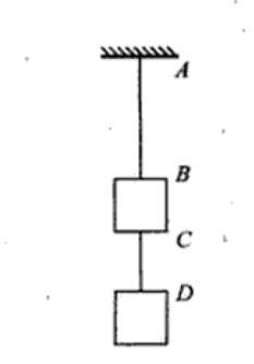

In summary, two blocks with masses of 3.3 kg each are connected by wires CD and AB. The linear mass density of CD is 8X10^-3 and the linear mass density of AB is 10X10^-3. The speeds of transverse waves in AB and CD are v1 and v2 respectively. The tension in CD is 32N, and for AB it is equal to the weight of the upper block + weight of the second block + tension at the upper end. However, the weight of the rope and tension variations along the rope are unknown. If we neglect the tension and mass of the rope, the tension in AB would be 64N.

Two blocks each having masses of 3.3 kg are connected by a wire CD and the system is suspended from the ceiling by another wire AB.The linear mass density of the wire AB is 10X10^-3kgm^-1 and that of CD is 8X10^-3.The speeds of the transverse waves produced in AB and CD are respectively v1 and v2 .Then find v1 and v2
The tension in the wire CD is 32N but I am slightly confused for the Tension in AB.
For AB, The tension is going to be equal to the weight of the upper block +weight of the second block +weight of the rope+tension at the upper end but I don't know about the weight of the rope and also tension will vary across the rope so How should I proceed here

CD supports the one weight below it and AB supports both weights below it. So what's the tension in AB?
On edit: Since the lengths of the wires are not given, you may ignore their masses for purposes of calculating the two tensions.
Likes harambe
You can assume that the weights of the wires are negligible compared to the weights of the blocks and you can also neglect the variation in tension between the bottom and top of each wire.
Likes harambe
That makes things easier then only the weight will act on the upper block
If we neglect the tension and mass of rope then it would be 64N
Yes, that's the tension in the upper wire. More correctly 64.7 N.
