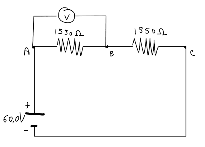

Draw a circuit diagram showing the three resistances. With 60V applied, what will the galvanometer read?

Schermata 2020-10-31 alle 11.53.32.pngso, this is my circuit
Considering the internal resistance of the galvanometer, it will "absorb" a current of ##I_{G}=\frac{60.0V}{R_{G}}##, which will be subtracted to that one flowing through the resistor... so it will measure a voltage ##V=(I_{initial}-I_{G})\cdot 1550\Omega##.
Does it make any sense?

View attachment 271902so, this is my circuit
Is the voltage across it 60V?
What current will flow around the circuit?
Right, the voltage across it is 30V.
Do you mean the current with or without the galvanometer applied? Which of the two is relevant?

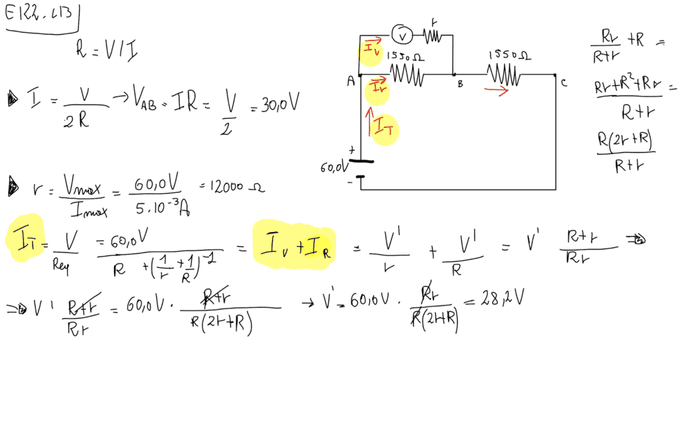

Auto-quote: I've managed to solve the problem applying Kirchhoff's 2nd law, @haruspex:
