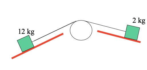

In a modified Atwood machine, assume the pulley is mass less and the string is mass less. The lower inline is 20 degrees above the horizontal and the upper incline is 8 degrees above the horizontal. the lower object is on the 20 degree plane and has a mass of 12 kg, the upper object is on the 8 degree plane and has a mass of 2 kg. Find the acceleration of the objects and the tension if the objects are sliding down the planes. The kinetic friction on plane to the object is 0.1.
OK. Let’s see your diagram of the apparatus.
Thanks for the diagrams. Here is a key question: Are the strings parallel to their respective inclines or at an angle relative to them as suggested in your figure?
They are parallel to the inclines.
Good, that simplifies things.
Since you are drawing two separate FBDs, you can have separate coordinate axes in each; they don't need to be the same. Draw them so that in each the x-axis is along the incline and the y-axis is perpendicular to the incline. Then only the weight will have x and y components which you will have to figure out. The tension and friction have only an x-component and the normal force only a y-component. The acceleration is along the x-direction only.
The most important thing to realize is that from each free body diagram you will get two equations, one for the x-direction and one for the y-direction which means a total of four equations. So at this point I will say that your equations in post #12 are incorrect. You only show two and you have a force "f" which is the same in both. If (as I suspect) it represents the force of kinetic friction, please note that, because the angles of the two inclines are different, the normal forces are different, therefore the forces of kinetic friction will be different even though the coefficient of kinetic friction is the same.
Consider all this and see if you can make some progress. We are here to help, but please post your work.

I really don't like the way that this was done. It is totally wild-ass (undisciplined).
Here is how I would have set up the problem: Let M be the 12 kg mass and m be the 2 kg mass. Then the force balances parallel to the inclines are:
$$Ma=Mg\sin{20}-Mg(\cos{20})f-T$$
$$ma=T-mg\sin{8}-mg(\cos{8})f$$
where a is the acceleration of M down its incline and also the acceleration of m up its incline.
Note that there is no overall "net force" in these equations. Do these in any way match the equations you wrote (I can't tell because you didn't leave it algebraic)? What do you get if you add these two equations together?
Yes these are my equations I had, I just neglected to put all the algebra in. Adding the forces together I get 29.96 N. I guess net force is bad terminology then for the forces acting on both objects.
Yes, because the net forces on each of the objects are pointing in different directions, and force is a vector. So if someone taught it to you in this way, they used bad judgment.

Easy to miss, but the angle of the upper incline relative to the horizontal is ##\theta_2=20^o+8^o## which affects the components of the weight.
On edit: Wait a minute, what happened to OP's drawing where both inclines were on the same side with the pulley where the slope changes? I am confused.
