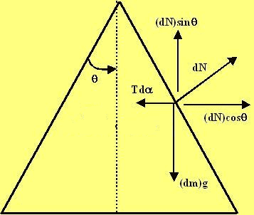

A rope of mass ##m## forming a circle is placed over a smooth round cone with half angle ##\theta##. Find the tension in the rope.
##\sum{F}=0##
I know how to solve the problem, but I have another way that I think should work but it doesn't. I don't know why.

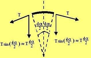

The way that this problem is done is to consider the tension on a small element spanning an angle ##\alpha## of the rope as shown in the following image:
. From there, we balance the forces on that small element as shown in the following image:
. We find that $$T={m \over 2 \pi}g \cot{\theta}$$

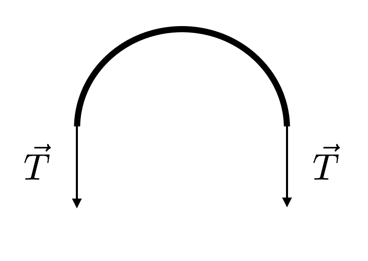

My question is why do we have to consider a small element of the rope? Why can't we consider half of the rope (that is, an element of the rope spanning ##\alpha = \pi##)? Therefore, the tension acts on the rope as in the following figure:

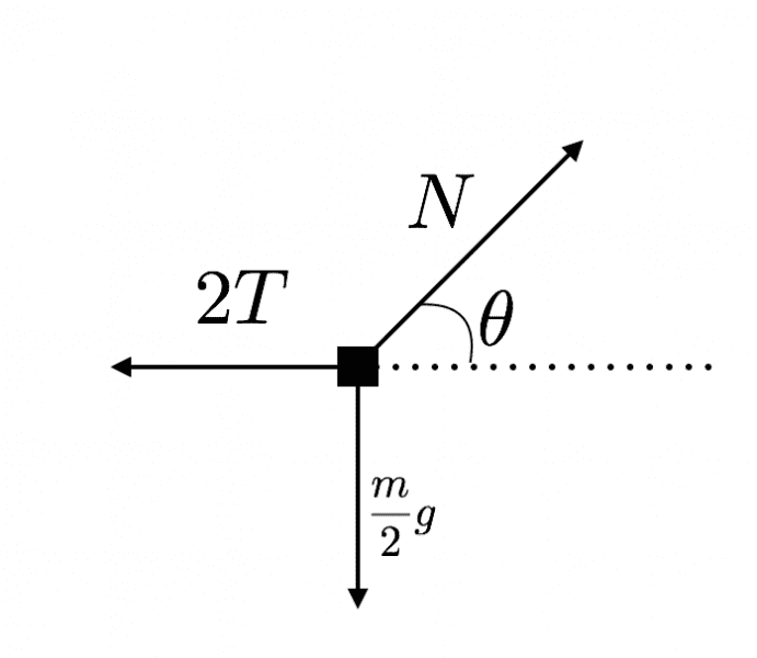

, leading to a free-body diagram as in the following image:
This leads to the result $$T={m \over 4}g \cot{\theta}$$ What's going wrong?
There is no tension at the end of the rope, and tension is not constant over the length.
In your alternate approach, I'll give you "2T" or "mg/2," but not both; "pi" ain't obvious to me yet.
How is the normal force acting on different parts of your string?
The rope is a full circle and has no end ;)
Oh, I misread how the rope is placed.
In that case: the force is not acting in the same direction everywhere.
Just as a comment regarding alternative ways of approaching the problem: I would actually prefer to solve this one by using energy methods. The answer drops out quite naturally without having to consider individual parts of the rope.
I know what's wrong with my alternative solution. The component of the normal force that opposes ##2T## is a sum of small normal forces acting in the direction opposite to ##2T##, which act on each element of the rope perpendicular to the surface of the cone. The force that opposes ##2T## can be found using integration and you get the correct answer.

Yeah, virtual work does give the result in like two lines. I was trying to find as many solutions to this problem as a could. I should have been more careful with my alternative solution above. I assumed the the force from the cone would be in a direction at angle ##\alpha## from the horizontal. For half the rope, this is not the case.
