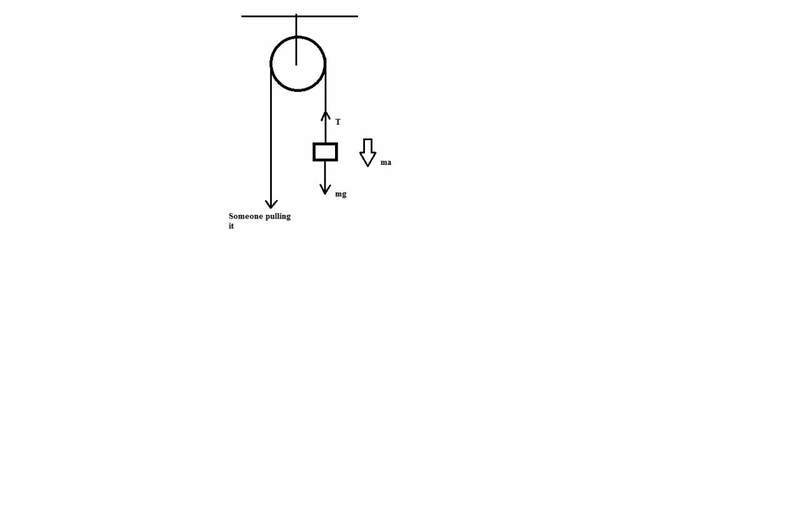

Check out my attachment... Is it the correct diagram?
If yes then you can see the force equations.
If no, I'm sorry for the inconvenience:redface:

Yes my diagram is similar but without the rope on the left hand side being pulled
to re cap
T= up
mg= down
ma=down
thus T-mg-ma = 0 correct?

You see, ma is actually the resultant of mg and T, right? Because (in the frame of reference of the ground) they are the only two forces acting on the block. So ma=mg-T.
Ahh... big help with
t = mg
Not sure where you are in the world but you may have heard the penny drop.
Thanks again Sunil Simha.
