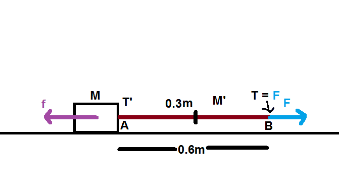

The tension on the rope will be maximum at point B, because the point B pulls both the block and the rest of the rope. It will be minimum at point A, as point A only pulls the mass of the block. You found the acceleration of the block + rope system to be ##a_{system} = 1.3 ms^{-2}##. What will be the mass of the section of the rope that is 0.3 m long?
Thank you for the drawing.The mass of that section is 0.7kg?Am i right.But how can the tension in the middle 17N?
Correct , it will be 0.7 kg. Now take the block and the section of the rope as a system( A to the black cut). What will be the acceleration of the system?

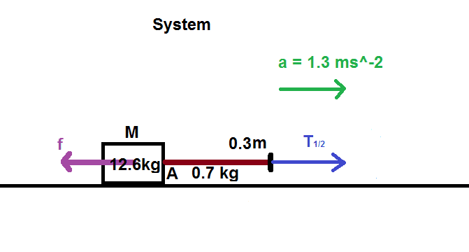

I think I messed up by not including the frictional force on the block + segment of rope system. Let me try again. So the system consists of the block and the rope A. Total mass of the system is ##M_{system} = 13.3 kg##. The external forces on the system are friction and the tension.
Using Newton's second law:
##\Sigma F = ma##
##T_{1/2} - f_{kinetic} = M_{system}a##
## T_{1/2} = M_{system}a + f_{kinetic}##
##T_{1/2} = (13.3 kg)(1.3 ms^{-2}) + (0.5)(126) = 80.29 N##
Please correct me if I am wrong.
##\Sigma F = ma##
You have taken g=10m/s^2 that's why you are getting more than 80N put g=9.8 result will be 79.1 N
