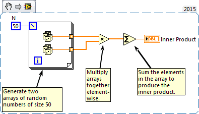

tkhunny said:
Weakness: LabVIEW does not have a generalized inner product.
Perhaps you could expand a bit on this? I know what an inner product is relative to an inner product space. Are you talking more about a specific programming language feature? LabVIEW can quite efficiently compute a typical inner product (really a dot product) thus:
LabVIEW has many, many vectorized operations similar to NumPy and MATLAB/Octave.
