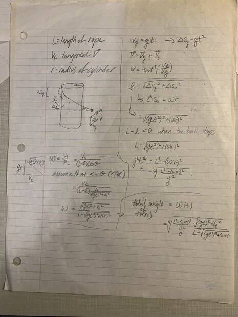

Not a homework question but an investigation:
A tetherball is tied to the top of a pole with a rope. When the ball spins around the pole, the rope starts to wrap around it. Using a pole with a fixed radius and a ball with a fixed mass, is it possible to find the number of wraps around a pole using a given initial tangential velocity?
Vt = rw
Fc = mv^2/r
My work so far is pretty basic, but I'm not too sure how to continue off from here. I haven't included the 2 dimensional aspect of it either, but I would presume that the rate of decrease in length is more sped up in that case? Would appreciate any help :(

Why not consider the two-dimensional analogue first: a circle of radius ##a## in the plane is the "pole", and a light, inextensible string is attached at, say, ##(a,0)##. Let the initial position of the ball be ##(a, L)##, where ##L## is the length of string, and let its initial velocity be ##(-v_0,0)##.
If the angle through which the string has wrapped is ##\theta##, then energy conservation implies that ##\dot{\theta} = v_0/(L-a\theta)##, but note that if the tension in the string is ##T## then the moment of the tension force is ##-aT## and the particle's angular momentum is not conserved. In any case, ##\dot{\theta}## is an increasing function of ##\theta## in the interval ##[0,L/a)## and the particle will collide with the pole no matter how small its (non-zero) initial speed ##v_0##; the number of wraps is always ##L/(2\pi a)##.
To make progress with the original query, you will probably need to play around with dissipation, string elasticity, etc.
Since it will descend at some (changing) angle, there's no advantage in taking the initial velocity as horizontal. In general, its velocity is angled down, making a right angle to the straight section of string.
I see no obvious relationship between the angle that velocity makes to the horizontal and the angle the string makes, though intuitively I feel they should be about the same.
In terms of the velocity, the current straight string length, the pole radius and those two angles, can you find equations for their rates of change?
Most likely, finding such equations is as far as you can go analytically. After that it would be simulation.
Likes DaveE, a sad student and ergospherical

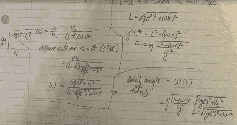

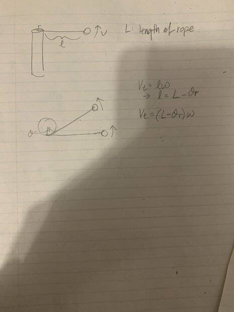

Thank you guys for the replies! I've tried to expand on the problem a bit more, but I'm having trouble coming up with an additional equation to solve it (?). I also think that the angles should be equal but I'm having a hard time coming up with a proof for it. Here's my work (sorry it's a bit of a mess! added the second image bc i realized the quality wasn't great)
It's easy to prove they are not necessarily equal: start it with the string down at some angle but with the mass going horizontally. What we might hope is that once equal they would remain equal, or better, that however they start they converge asymptotically to being equal.
