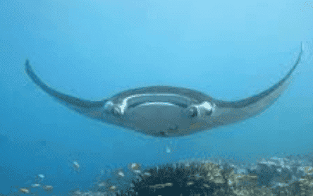

Here's some possibly relevant biology:
Manta rays are rather solid and heavy. Their "wings" (pectoral fins) are thick, strong, and meaty. Being water animals this is not much of a drawback since their size can make them close to neutrally buoyant while still having a lot of muscle for moving them selves.

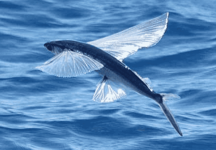

The flying fish I have seem in the Gulf of Mexico are more slender in build. Their wings (pectoral fins) are delicate:
more like a an insect's wings.
On the other hand, they can drag their tail in the water and sweep it back and forth and do a powered skim of the water for hundreds of yards. Really impressive to see.
Fishing in the Gulf (of Mexico) has given me a great appreciation for flying fish. They are very impressive. I've been hit by flying fish evading predators in my efforts to fish for the predators (usally tuna, sharks, or billfish). You can actually catch them at night in a net at a light, and they are remarkable bait for tuna. It does take some stones to be 80 miles offshore in the dark, attempting to net flying fish while you drift around an exploration rig in a basically tiny boat...

Sadly, actual manta rays don't really have much of a tail and its not muscled for propulsion.
Sting rays use it for defense, by flicking around the stinger in their tail.
However, fictional world, modifications should be OK.
Manta rays are like cows of the ocean. They filter feed plankton (like a whale shark or baleen whales).
Large size prevents a lot of predation. Not sure how that works with the smaller young.
The flying fish are smaller fish with larger fish predators (thus their escape behavior mentioned by @ChemAir). They eat smaller fish and probably zooplankton (larger plankton that eat smaller plankton).
A good reason for a behavior to evolve, provides a more plausible story, in my view.
