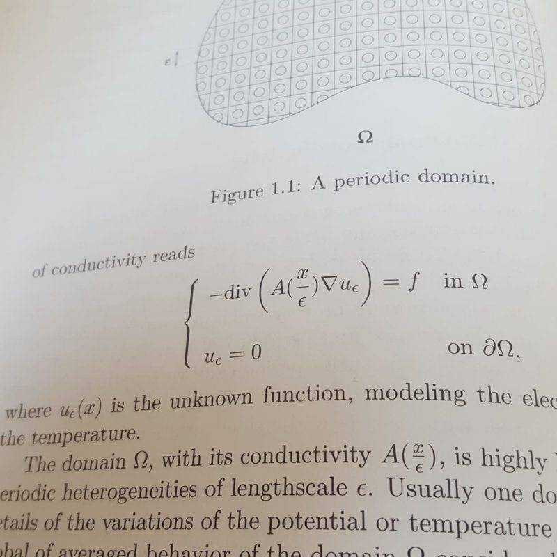

Background: I am currently reading up on homogenization theory.
I have a simple conductivity model (image attached). u is a scalar function (such as potential or temperature).

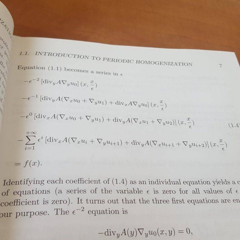

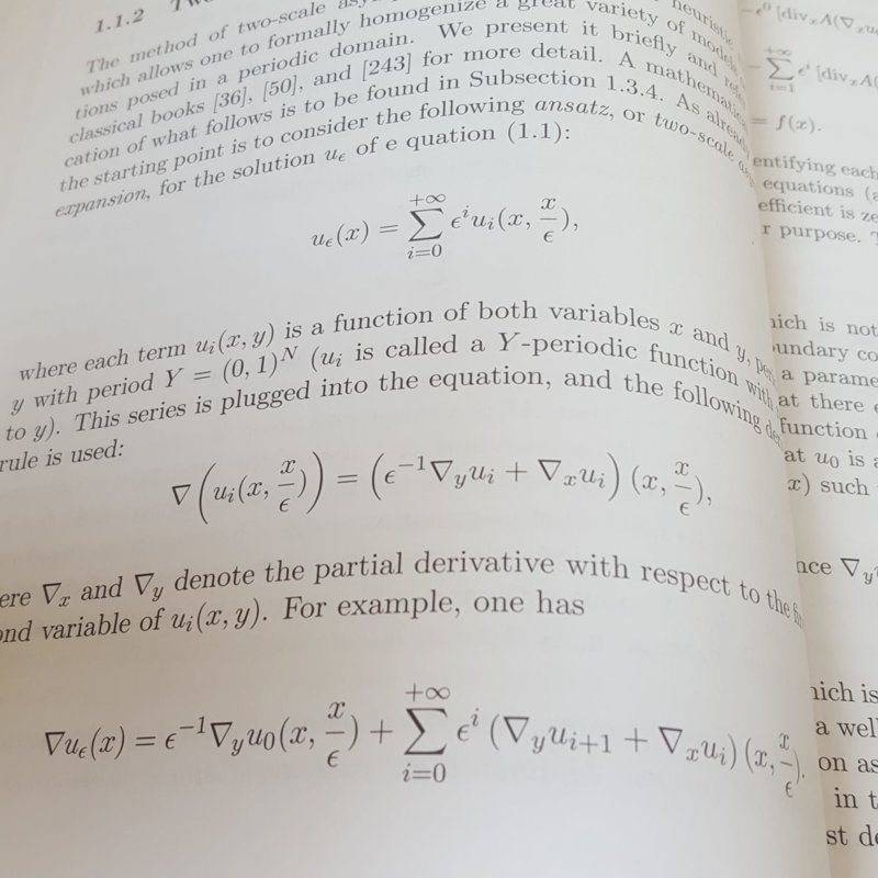

The textbook proceeds by giving a series expansion for the gradient of u (image attached). the problem is that the gradient is supposed to be a vector function, and the one given is a scalar (pretty sure that the expression given by the book is the differential)
The fact that the gradient is supposedly a scalar makes the divergence operation in the model undefined, which basically makes all following math in the book unclear to me..
How to makes sense of it?

Pity we can't read the numbers of the equations; this makes referring to them confusing.
'Thiis series is plugged into the equation' -- study 'the' equation to find out what they mean with ##\nabla_y## and ##\nabla _x## --- my guess is that 's a scalar equation, e.g. for the ##z## component, not a vector equation.
But only a guess, given the little I have to go on.
Thanks, I believe I have found the cause of my confusion.
The model problem is 1-dimensional (x is the only free parameter). This makes the gradient a scalar in the sense that it is a magnitude that can either be positive or negative.
This also makes the divergence and the gradient basically mean the same thing.
This seems to make things work out..
