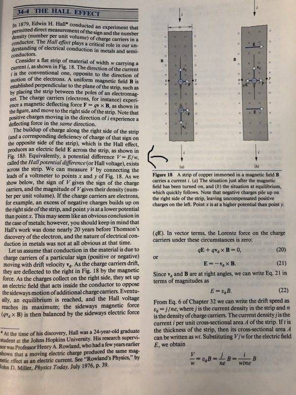

Textbook says V=E/w but units don't match
In summary, the conversation is discussing the Hall Effect on a flat conductor with width w carrying a current i in a uniform magnetic field perpendicular to the plane of the strip. The textbook states that this will create a potential difference of V=E/w, where E is the induced electric field from the electrons moving to the right side of the material. However, upon further analysis, it is discovered that the dimensional analysis of V=E/w yields a unit of kg/(s^3*A), which is false. This is due to a typo in the formula, which should be V=Ew. The book in question is Halliday and Resneck Physics Volume 2 4th edition, page 745.

In my textbook, it is talking about the Hall Effect on a flat conductor with width w carrying a current i in a uniform magnetic field perpendicular to the plane of the strip. It says that this will create a potential difference of V=E/w where E is the induces electric field from the electrons moving to the right side of the material.
In normally, E=volts/meter, but here, we have E=volts*meter.
Doing deeper dimensional analysis based on V=E/w, we get kg*m^2/(s^3*(A)=(kgm/(s^3*A))/m=kg/(s^3*A) where A is current, which is false.
Why is this potential difference formula different?
Because it's a typo.
It should be V=Ew, right?
Right.
What book? What page? Can you post a scan of the page?
Halliday and Resneck Physics Volume 2 Edition 4 page 745.
Wow! 4th edition. That's an old one.
