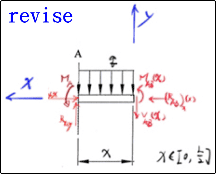

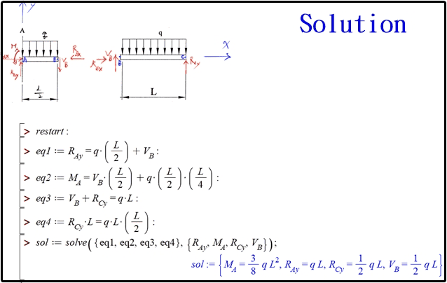

Q:Please help me to understand why to solve the bending moment of Ma by using the energy method is different from the solution?
Relevant Equations as follows.
Thank you for your time and consideration.
I'm not sure what energy method you are using, but since the problem is statically determinate, you don't need to know any rotation angles. B is a hinged joint, not a support, so there is no moment in the beam at B. The solution appears correct. Keep it simple.
