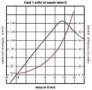

The lift coefficient ratio will be obtained from Kl1(33+12)² = Kl2(42+17)², where Kl2/Kl1 = 0.58. Based on a typical airfoil, assuming the angle of attack at low speed was 15°:
Then the high speed angle of attack was 6°. From that the ratio Kd2/Kd1 could be as low as 0.40. But we only need 0.58 from Kd1(33+12)² = Kd2(42+17)².
jack action:
If Kd2 = 0.4*Kd1 then Ro1/Ro2 = 0.457 * (Kd1/Kd2) = 0.457 / 0.4 = 1.14 (see my previous post) which means that Ro2 = 0.875 * Ro1. In other words the efficiency of propellers has to drop also despite the fact that, in the second case when the plane flies faster (42 ft/sec ground speed), the angle between the thrust vector and horizontal decreases from 15 to just 6 degrees. Logically the propellers should be more, not less, efficient when the attack angle of the wings is just 6 degree as compared with the case when the angle was 15 degrees (Thrust * cos (6) > Thrust * cos (15) ).
What I said is «could be as low as 0.40». I used data from a more modern airfoil (Clark Y), as I don't have the ones from the Wright airplane, to show that getting such a value for Kd2/Kd1 was possible and realistic. You seemed to doubt that a Kd2/Kd1 = 0.676 was possible.

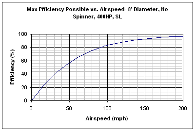

As for the propeller efficiency, if we keep it the same for both cases, then Kd2/Kd1 = 0.457 and that is greater than 0.40, so it is a possible value. If the propeller efficiency increases, then Kd2/Kd1 increases as well, which makes it even more possible.
Also, from the graph below (source), you can see that going from 23 to 29 mph (33 to 42 ft/s), the increase in efficiency is about 1.29. So such an increase seems to be a possibility as well.
If we take Ro1 = Ro2 = Ro then the useful power available in both situations is P' = Ro * P. Using this P' the plane flies at 33 ft/sec when the wind is 12 ft/sec and faster at 42 ft/sec when the wind is 17 ft/sec. Therefore, the machine is more efficient in the second case as long as it travels a longer distance in the same time.
The main question is: If Flyer II was capable to fly at 33 ft/sec against a 12 ft/sec wind, staying firmly in the air, and then, in the second case, to run faster at 42 ft/sec against a stronger 17 ft/sec wind, for what reason was this plane unable to accelerate from 33 ft/sec to above 42 ft/sec in a 12 ft/sec headwind?!

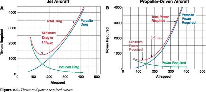

What is k / v(t)^2? Is that derived from an equation equating drag and thrust? I really think this is easier to conceptualize than trying to build equations to describe it. This was in Andre's link (graph at right):
As you can see, the power required to stay aloft at 75 (whatever unit of speed) is higher than the power required at 125.

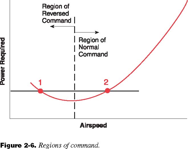

russ_watter:
Source: http://www.americanflyers.net/aviationlibrary/instrument_flying_handbook/chapter_2.htm
If the 1904 plane had been able to fly in both reversed and normal command regions then, as can be seen in the general theoretical diagram (Figure 2-6.), for a given power P there are only two solutions, points 1 and 2. Assuming the total airspeed in 1 is 33+12 = 45 ft/sec the second point can have the airspeed 42+17 = 59 ft/sec and it appears that W. Wright described a real situation or at least physically possible, when, in his Aug. 28, 1904 letter, he wrote that his plane had flown faster in a 17 ft/sec headwind than against a 12 ft/sec wind.
However, in the same letter W. Wright also says:
"Dayton, Ohio, August 28, 1904.
... Since the first of August we have made twenty five starts with the #2 Flyer... . We find that the greatest speed over the ground is attained in the flights against the stronger breezes."
which means that, in general, he remarked that the airspeed (Vp+Vw), recorded by a device on the plane, increased as the wind intensified. However, as the diagram shows, only two solutions exist: (y=P, x=45 ft/sec) and (y=P, x=59 ft/sec) and nothing else.

The question is why should the pilot artificially force Kl to decrease so dramatically with speed?
Because he wants to maintain steady flight.
Two solutions for a power that equals drag. Clearly, if the plane is accelerating, the power doesn't equal the drag.
Can I ask what the point of all this is? It seems really obscure.
russ_watters:
Because he wants to maintain level flight.
Wilbur Wright wanted to fly as much as possible. His intention was not to maintain level flight but to stay in the air by any means.
In fact all this story regarding the angle of attack is pure theory because Flyer II had a sinuous trajectory being up and down all the time, flying like a bat (this is the claim).
Climbing would have helped because, a bit later after reaching a certain height, Hmax, the plane would have used his potential energy mg(Hmax - Hmin) to accelerate to a high enough velocity to stay stably in the air at Hmin, even if the wind had dropped to zero.
russ_watters:
But the plane was not accelerating in the two cases (wind speed 12 and 17 ft/sec) W. Wright talked about in his Aug. 28, 1904 letter.

It appears that it would be much more logical to try to keep Kl constant and let Kl∗v^2 grow larger than m*g which means that the plane will gain altitude.
It is not a matter of logic. You asked: «How is it possible?» We answered: «If the plane keeps its altitude, it is.»
simplex1 said:
I have started from the assumption that Kl and Kd are constant for the range of air speeds [45, 59 ft/sec] of interest.
This assumption is wrong (or at least badly worded) because both of these variables are independent of speed (within reasonable limits). They only depend on the shape and position of the object within the air stream. The pilot controls both shape and position of the plane to steer it.
simplex1 said:
People on the forum came with the idea that both these quantities are in fact variables:
Kl = Kl(alfa) = (for example) a*alfa^b (also it can be any formula you propose)
Kd = Kd(alfa) = (for example) c*alfa^d
where a, b, c, d are some known parameters which have to be given as numerical values.
From the two relations above we can find:
Kd = Kd(Kl)
and quickly calculate the amount of drag induced by a Kl = m∗g / v^2 and see if drag really goes down when the airspeed increases.
You are again mixing positioning with speed. Your equations are solely dependent of alfa and you are concluding «[we will] see if drag really goes down when the airspeed increases.» You'll never be able to prove that with your equations, as they are clearly independent of speed.
What they are, is dependent of the pilot 's intention. If the airspeed changes and the pilot does nothing, the plane will instantaneously either go up and slow down (airspeed increases) or go down and speed up (airspeed decreases).*
But IF the pilot decides to change the shape and/or position of its plane in a precise way, the plane will stay at the same altitude. What he actually did was in fact reducing the lift coefficient. By doing so, he also has decreased the drag coefficient, which means the plane will accelerate under the same thrust. And, within reasonable limits of airfoil designs, drag and lift coefficients are proportional to one another: When one goes up, so does the other, and vice-versa. It is a fact for all airfoils.
So when you ask «How is it possible?» The answer is: «It is possible if the pilot decides to change the angle of attack of its plane.»
The problem now is that you seem to refuse that the Wright brothers have different angles of attack in the different passes, even though nothing seems to be mentioned to support whether it is or it is not.
All we can say right now is, if the angle of attack was different under different headwind, the speed can be faster in the larger headwind.
* When you say:
Choosing to gain altitude might not be an option. Even though the lift force increases and the plane wants to go up, the drag force also increases, slowing down the plane, which in turn reduces the lift force. There is a point where the plane will not be able to climb up anymore, no matter the strength of the headwind.

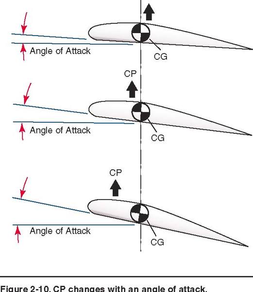

looks to me like you guys are all thinking steady state.
all math aside, let's apply some psychology and transient analysis to this question.
a craft so heavy and underpowered is going to feel like it's barely flying, much like a small boat trying to climb up over its bow wave onto plane where lift/drag is less.. If you ever water skied you've felt this "climbing your bow wave" when you first get up.
A gust of headwind cannot immediately decelerate the craft because of its substantial inertia so might push it "over the hump" so to speak.
Then there's the fact Wrights were sensitive about falls. That's one of the reasons they chose Kitty Hawk, for its soft sand to lessen impact..
So it's very plausible to me that a gust might well lift the plane causing Wilbur to push nose down with no other thought than to make his impending fall a shorter one. Surely the deceleration would feel a lot like prelude to stall.
Nose down would move center of lift aft on the wing thus reducing drag in this new stable attitude., one which he simply lacked the horsepower to reach unaided by outside forces.
(sorry, the images are in reverse order)
http://www.americanflyers.net/aviationlibrary/pilots_handbook/chapter_2.htm
The Wrights knew plenty about AOA. Did their flyer have such a gage? I suppose a piece of yarn trailed from one of the support wires might have worked, if he wasn't too busy to watch it.

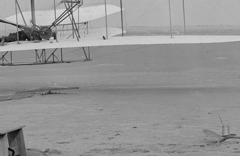

1) Regarding Flyer I (1903) it looks like gravity supplied an important part of the thrust the plane needed to stay in the air and the vertical component of the wind also aided Wilbur's machine to float. If the well known photo with Orville Wright just taking off and his brother looking at the plane, was really taken on Dec. 17, 1903 (the image was first published in Sep. 1908), then it is quite clear from the detail you can admire (see the attached picture) that Flyer I performed a power assisted glide at best.
The first flight on December 17, 1903. Flyer I taking off and just about to go down along a slope..
2) "They carried the machine up on the Hill", John T. Daniels, eye witness
The fact that Flyer I 1903 just glided, aided partly by the engine, was confirmed apparently unwillingly by John T. Daniels, an eye witness, in a letter addressed to a friend:
"Manteo NC, June 30 —- 1933,
Dear friend,
I Don’t know very much to write about the flight. I was there, and it was on Dec the 17, — 1903 about 10 o’clock. They carried the machine up on the Hill and Put her on the track, and started the engine … and he went about 100 feet or more, and then Mr. Wilbur taken the machine up on the Hill and Put her on the track and he went off across the Beach about a half a mile …
John T. Daniels, Manteo NC, Box 1W"
Source: http://wrightstories.com/eyewitness-account-of-first-flight-by-john-daniels
3) The 2003 flying replica of Flyer I 1903 couldn't fly more than 115 feet (35 m)
The 2003 accurate replica of the Wright brothers' 1903 plane was not able to do more than short flights. None of its takeoffs came close to the claimed 59 seconds flight performed on December 17, 1903. What the 2003 experiment really showed was that Flyer I could have been theoretically able to take off and fly chaotically for 100 - 115 feet, no more. The 1903 machine was uncontrollable and not able to perform a sustained flight.
"On November 20, 2003, Dr. Kevin Kochersberger piloted the 1903 Wright Experience Replica Flyer. With 15-18 mph winds he flew a distance of nearly 100 feet."
"December 3, 2003 test flight of the Wright Experience 1903 Wright Flyer Replica. Dr. Kevin Kochersberger was at the controls and piloted the Flyer for a distance of 115 feet. Slight cross wind after initial rotation which is compensated with slight wing warp."
The instability of Flyer I had been already predicted by prof. Fred Culick who tested in the wind tunnel another replica, different from the one that flew in 2003:
""They built it and then drew as they went along," said Fred Culick, professor of aerodynamics at the California Institute of Technology and chief engineer on Cherne's team. …" Cherne's group, working mainly on weekends in a warehouse donated by a rocket company in El Segundo, finished what they considered an exact replica. Then in 1998 they tested it at NASA's Ames Research Center near Sunnyvale, Calif. Three weeks of wind-tunnel tests of their Wright Flyer replica "clearly showed how unstable it was and how it can't be flown safely," said Culick."
Source: http://community.seattletimes.nwsource.com/archive/?date=20031008&slug=wright08
4) "the brothers only “glided” off Kill Devil Hill that day. Their first real flight came on May 6, 1908", Alpheus W. Drinkwater, telegraph operator
"Wilbur and Orville Wright are credited with making their first powered flight in a heavier-than-air machine on Dec. 17, 1903. But Alpheus W. Drinkwater, 76 years old, who sent the telegraph message ushering in the air age, said the brothers only “glided” off Kill Devil Hill that day.
Their first real flight came on May 6, 1908, he said."
Source: New York Times, Dec. 17, 1951.
The declaration of Alpheus W. Drinkwater corroborates well with the article "The Wright brothers in US and in France - The last tests of the Wrights' in US described by themselves", L'Aérophile, June 1908, pag. 222-223" ( http://gallica.bnf.fr/ark:/12148/bpt6k6550620m/f232.image.r=wright 6 mai.langEN ) where the two brothers talked, amongst others things, about a 337 m flight, against a 4-6 m/s headwind, that took place on May 6, 1908. As a remark, this is the first claimed powered flight mentioned by the Wright brothers after they stopped flying (also a pure claim) in October 1905.
