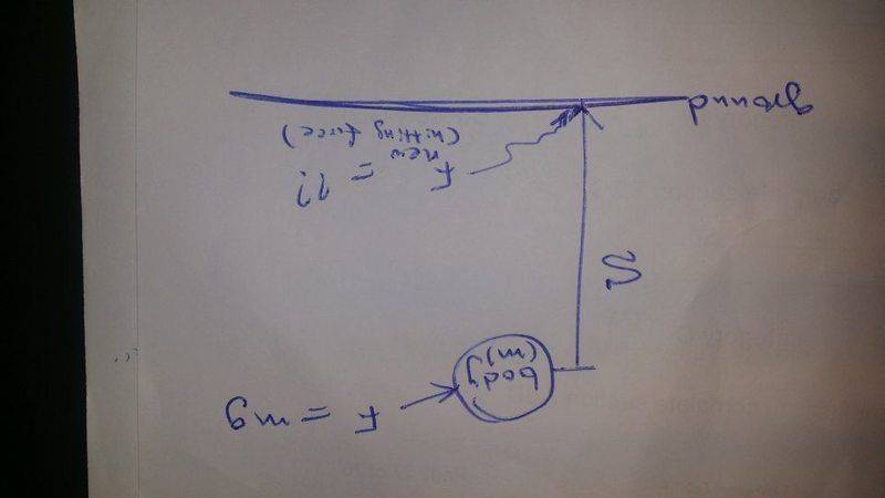

1. problem:
a body of mass started to fall from rest, and from S elevation. what is the equation that calculate the force of what this body will hit the ground?
:[/B]
F=mg // which is used to calculate the force of the body on the ground when it is already on the ground
[/B]
F_new=F*S
// I am here taking S as a unitless number that would multiply the force over distance, but really don't know if this is the right handling of this problem.
May you help please/

F_new: the foce of the body when hitting the ground after being fell
F=mg ...... (1)
F=m[v2-v1]/t
//v1=0
F=[m * v2]/t
Hi, i did applied Newton law -> v2^2 = 2gS
and i got finally, the rule: F=[ m * (2*g*S)^0.5] /t ...... (2)
lets assume: m=100 kg, g=9.81 m/s^2, s=0.3 meter, t=1sec,,
the confusion is:
- if i applied equation 1: i get the answer: 981 Newton (a) // represents as if the body at rest
- if i applied equation 2: i get the answer: 242.6 Newton, (b) // represents when body is just hitting the ground after being fell.
i get here the answer (b) less than the answer (a) !
Any correction ?>>>!

any body at rest, like me now setting on my chair, my weight is then -> F=mg.
Now, let's say that i thew myself from the window at rest, and i fell over a car, i presume then, that my force just over the surface of this car is bigger than F=mg at rest, due to the distance I have fell though. So, i am asking what is the magnitude of that force when just hitting the surface of that car?but after our discussion, i found i should consider talking about the impact force, since effect of impact force is the way of how the body will discharge the energy earned by accelerating in space.

As I read the above:
You have a 100 kg object falling 0.3 meters in a 9.8 m/s2 gravity field.
You assume without evidence that the ensuing impact will last for one second.
You correctly calculate the impact velocity using v2 = 2gS.
You correctly divide the impact velocity by the impact duration to determine the impact acceleration and multiply by mass to get impact force.
You neglect the required upward force to resist gravity while the impact is taking place.
You correctly conclude that the net upward force required to produce the observed upward acceleration is 242.6 N.
You compare this to the gross upward supporting force required to hold the object in place against gravity.

Peter... Have you studied the equations of motion under constant acceleration (eg SUVAT equations)?
If so perhaps try applying none of these to the deceleration phase that occurs when an object hits the ground...
Try assuming that it penetrates the ground a dist since "s" and use that as the stopping distance in the equation. What happens to the deceleration "a" if the ground is harder and hence the penetration and stopping distance is reduced? What happens to "a" if the stopping distance reduces to zero? What is the implication for the force?
Thanks indeed for you all :)))
The responses above are trying to get you to think of force in terms of F=mA. The force is directly determined by the acceleration (or deceleration). Will the deceleration at any time be the same if it falls into mud or water or steel? You need to work from there and you might need more information to calculate it. But the force is spread over time and changes, so that might get messy. Are you sure that you have the correct problem statement? I suggest that you keep this in mind and review the hints others have given above.
