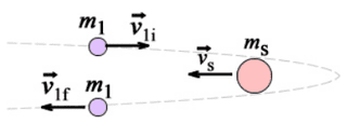

Here is a gravitational slingshot figure from some homework exercise :
##m_1## is a small mass, say, a space probe, and ##m_s## is Saturn. The direction of ##m_1##'s velocity completely reverse direction due to Saturn's pull. ##m_1## come from very far away and end up very far away as well at the end.
Using conservation of momentum (and conservation of energy, if you're not resolving the problem from the center of mass frame of reference - approximated by Saturn's center), one can find out ##v_{1f}##, the speed of ##m_1##on its way back.
That speed ends up being ##v_{1f} = v_{1i} + 2v_{s}##. ##m_1## has more kinetic energy after the "collision" than it had before. It stole some of Saturn's energy. Saturn's speed has decreased an infinitesimal amount (because it is so massive).
So energy has been transferred.
What annoys me is that I don't see any net work done (work done by gravity add up to 0 here right ?), or radiation, or heat, or so. What is the "agent" by which energy has been transferred ? By what mean does energy flow from Saturn to ##m_1## ?
Or is it just "conservation of momentum" and that's it ? Sounds quite different from usual cases where you can compute the work done by a force, or the quantity of heat transferred in a system, or the Poynting vector of an absorbed EM wave, and so on.

Energy is not an invariant quantity. It varies with choice of reference frame. The amount of energy that is transferred (and in which direction) is also not an invariant quantity. It varies with choice of reference frame. It is, in effect, a mere book keeping entry rather than a real physical quantity.
You seem to be looking for a physical explanation for a book keeping entry. You will not find one.
Gravity. The work done by gravity on the slingshotted object is non-zero.

There are a couple of ways to look at it.
If Saturn is stationary then its gravitational field is static. Gravity is a conservative force and has an associated potential. The only way you gain kinetic energy is by losing potential energy. And vice versa. We seem to be in agreement on that point. If Saturn is moving then its gravitational field (as seen from our chosen standard of rest) is changing over time. This opens up other possibilities.
But let us switch to a different viewpoint.
The easiest way is to use the analogy of a ball bouncing off a wall (as you proceed to do). The key point is that when the ball hits the wall, it is pushed. When the object slingshots around Saturn it is pulled. You seem to be focusing your attention on the long approach toward Saturn and the long departure from Saturn. But that is not where the important effect happens. The important part is when the object is very close to Saturn and is being pulled the hardest. That is where it gains its leftward (per the drawing) velocity.
If Saturn is at rest then the leftward velocity at which the object begins its departure from Saturn will be equal to the rightward velocity when it finishes its approach.
If Saturn is moving to the left then its leftward velocity relative to Saturn at departure will still be equal to its rightward velocity relative to Saturn at arrival. In our rightward-moving reference frame, its arrival velocity will be lower than this and its departure velocity will be higher than this. It will have gained energy.
One can account for this by noting that while it was whizzing by the moving Saturn at its point of closest approach, the object was moving leftward under a leftward force. That force was doing work on the object.
The kinematics of a gravitational slingshot are exactly the same as bouncing the probe off the planet. Don't look to find differences. You have an exchange of momentum and kinetic energy in both, and the amounts are exactly the same.
