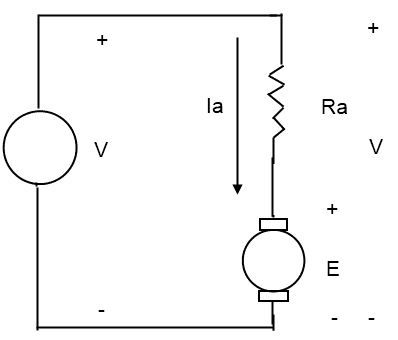

The resistance of the armature windings of a DC motor is 5Ω. The motor is connected to a 120V line. When the motor is spinning at full speed, it draws a current of 4A. The back EMF at full speed is:

This isn't correct. I also didn't know what to do with the 120V line.
Presumably in the motor the back EMF opposes the line voltage. That reduces the net voltage that appears across the winding resistance, and it's the net voltage that drives the current through the winding resistance.
Does that mean that the back emf is equal to the line voltage minus the peak emf?

Peak emf? At constant rotation rate ("spinning at full speed") the back emf will be a constant value.

Here you're dealing with a DC motor. The supply voltage is DC. You can expect the back emf to be a constant DC value as well so long as RPM is constant.
If the supply voltage is V and the back emf is E, and the current is I and the coil resistance is R, (whew!), then if E opposes V, what is the current? What formula would you write for the net potential if "E opposes V"?

Nope. Because 120V is the line voltage, not the net voltage across the coil. The back EMF opposes the line voltage. Also, you're GIVEN the current...
...E= -V?
Nope. That would make the net potential across the coil zero, so that no current would flow.
Perhaps a simple diagram will help:
If you treat the EMF voltage E as a simple DC Voltage supply, what would the equation for Ia equal? You can then move that around to solve for E.

Okay. So. You meant find the voltage in the motor. I suppose that would be V=IR=4A x 5Ω=20V.

Umm... E= Vline-Vmotor
Yes, that looks good. So E = ?

120V-20V= 100V
