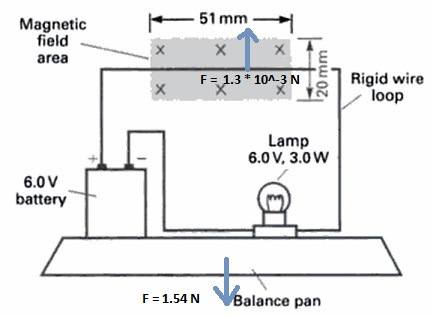

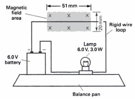

The diagram shows a rigid conducting wire loop connected to a 6.0 V battery through a 6.0 V, 3.0 W lamp. The circuit is standing on a top-pan balance. A uniform horizontal magnetic field of strength 50 mT acts at right angles to the straight top part of the conducting wire in the direction indicated in the diagram, i. e. into the paper. This magnetic field extends over the shadowed area in the diagram. The balance reads 153.860 g. Calculate (a) the force exerted on the conducting wire by the magnetic field, and (b) the new balance reading if the direction of the magnetic field is reversed.
Answers: (a) 1.3 * 10-3 N, (b) 1.54; 115 g.
2. The attempt at a solution
(a) F = B I L. First we find I = P / V = 3 / 6 = 0.5 A. Plug it into the F formula: F = (50 * 10-3) * 0.5 * (51 / 10 / 100) = 1.28 * 10-3 N. This part should be correct.
(b) This part I have large doubts. First of all, what does "The balance reads 153.860 g." mean? And second of all what does the answer "(b) 1.54; 115 g" mean?
There are two styles of representing numbers: (i) 1,000,000.00 -- one million and (ii) 1 000 000,00 -- also one million. The mass -- what does it mean? .860 is the faction? Or it is 153 860,00? Or 153,86?
I also don't understand the answer. If we need to find the mass, which is 115 g, then what is 1.54?
And finally, how do we find the new balance reading? As I understand, the direction of force was upwards (current is going from +, so current is going from left to right through the wire and field), the field was into the paper, so the force was directed upwards. And now when the field is out of paper, the force is directed downwards. But that's as far as I can go.
Maybe F = m g so m g = B I L? Why do we need the 20 mm though...

The force points upwards. We have current from left to right and field directed into the paper. So the force is directed upwards.

F = m g = 0.15386 kg * 10 = 1.54 N the weight force.
FUp = 1.28 * 10-3 N, the force directed upwards.
How can they be equal if they are not?
The new force will be directed downwards. And the weight is directed downwards.

We have the force directed upwards from the field. There is the weight force directed downwards. I don't see any more forces.
The setup is on top of a scale. There is a force between setup and scale - and you calculated this force already.
Likes moenste
Like this?

Force on the scale (as you said).
So the scale is pulling the setup downwards? The force balance for the scale does not matter, this is all about forces on the setup on top of the scale.
And where did gravity go?

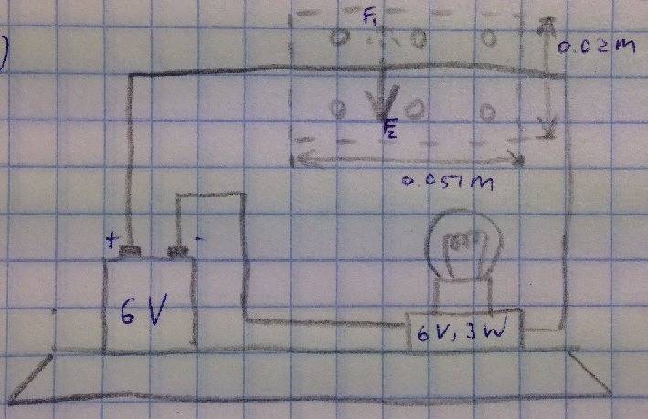

Situation 1:
(i) Force directed upwards. F = 1.275 * 10-3 N.
(ii) Force on the scale: F = m g = 0.15386 * 10 = 1.5386 N.
(iii) The weight is the force directed downwards. If we have one force directed upwards and one force directed downwards then: 1.5386 + 1.275 * 10-3 = 1.539875 N.
Situation 2:
(i) Force directed downwards. F = 1.275 * 10-3 N.
(ii) Weight directed downwards: F = 1.539875 N.
(iii) Force on the scale is equal to total force, since both forces are directed downwards, therefore we sum the forces up: F = 1.275 * 10-3 + 1.539875 = 1.54115 N.
Now to find the new balance reading: m = F / g = 1.54115 / 10 = 0.154115 kg or 154.115 g. Is this the correct answer?
