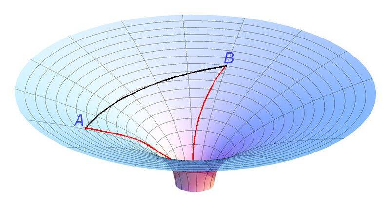

I take it that you don't like my idea of the rotating gravitational field 'dragging' the light round. Is there any way of using Flamm's paraboloid? Would a 'great circle' route on the paraboloid be an accurate way of plotting the path of a light beam under the influence of spatial distortions only (i.e. the EP effect would be in addition.)
This one is trickier than it seems, because in GR the notion of "gravitational field" is very limited.
Something analogous to a classical gravitational field is only found in a few (important and frequently discussed - the spacetime around a massive body like the sun is one) situations, and none of these involve the sort of rotation that you're considering. For more general cases, in principle we specify the distribution of stress and energy, insert this in the Einstein field equations (64 coupled non-linear partial differential equations), solve for the metric tensor, and then calculate the paths of things (objects in free fall, flashes of light) as they move through the spacetime described by that metric tensor - a "gravitational field" that we consider to be exerting a force on objects just isn't anywhere in the solution.
Flamm's paraboloid is applicable to only one particular situation: a non-moving isolated massive spherically symmetric object like the sun. It won't be much help trying to visualize anything else.
Likes vanhees71

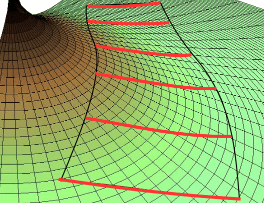

I would be happy to stick to the case of a non-moving isolated massive spherically symmetric object like the sun!
The attached file shows Flamm's paraboloid on which I have traced a great circle route (black) and a 'straight line' route (red). Would you not agree that it is appropriate to say that the former is the 'shortest' route from A to B and that it does, at least qualitatively, describe the sort of path to be expected on the basis of the spatial distortions around such an object?
In GR, the geodesics followed by massive particles are the longest (not the shortest) path between two points. That said, the null geodesics that light follows have zero length.
J O Linton said:
Flamm's paraboloid
Is, unfortunately, not a good tool to use for your intended purpose. All it shows is one particular aspect of "space curvature" in one particular system of coordinates. It does help with some intuitions (for example, intuitions about purely radial motion and "climbing out of the gravity well"), but not with others (such as motion with a non-radial component, as you are considering here).
No and no. The problem is that freely falling objects (light, planets in orbit, spacecraft launched by humans) travel on geodesics of spacetime, not space. The geodesics of the Flamm paraboloid are simply the wrong ones to be looking at.
Likes vanhees71 and PeroK

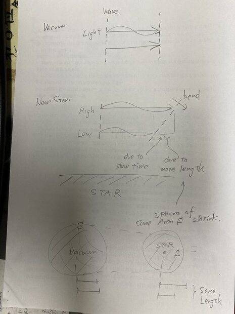

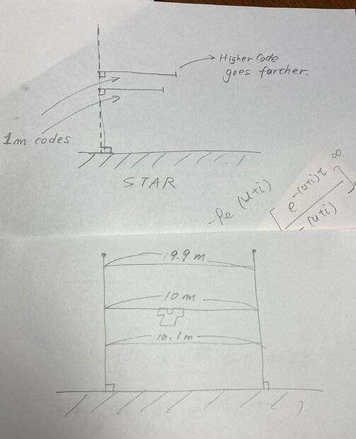

anuttarasammyak said:
[edit]
As one approaches to sun
time pass slowly
periphery/radius becomes longer
These double effects matter.
I draw sketch to explain it.

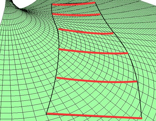

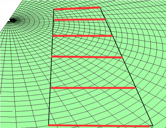

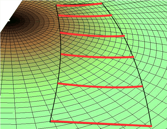

My suggestion about Flamm's paraboloid was dismissed by one contributor but I think he mistook the diagram for a potential well. In fact I believe that Flamm's paraboloid (which as you know is a surface whose metric is the same as the spatial component of the Schwartzchild metric) can be used to provide a legitimate (qualitative) explanation of the bending of light, particularly if the paraboloid is inverted so that there can be no confusion with the more familiar potential well diagram.
Essentially the idea is that the temporal component of the bending is due to the fact that light passing near the star travels more slowly (just like sound waves traveling over water or light waves in a graded index optical fibre); the spatial component is due to the fact that radial distances are 'stretched' closer to the star and therefore light which passes close to the star has further to travel. In traveling from a point A on one side of the star to a point B on the other, a light ray chooses the path with the shortest travel time. (The contributor who mentioned that in GR a geodesic maximises the proper time was confusing proper time with elapsed time. In any case the proper time of a light ray is always zero whichever way it travels.)
The attached diagrams should illustrate the way in which I shall in future explain to my students why the bending of starlight is twice the bending predicted by Newton and the EP.
(BTW Please do not think I am directing these comments at you, Ibix, as I am sure your understanding of GR is much better than mine. I have explained my ideas at length in the hope that other readers of this post will gain a better understanding.)

J O Linton said:
I think I have come to a satisfactory understanding of the issue now.
Unfortunately, you have not. See below.
J O Linton said:
I don't think it is quite true to imply that the spatial effect is global which the temporal (EP) effect is local.
You are incorrect. If what you call the "spatial effect" were local, it would appear in the equivalence principle analysis, and it doesn't.
J O Linton said:
All physical effects are local
This is incorrect as well. The way different local patches fit together, which is where the "spatial effect" you refer to comes from, is global, not local. (Note that this means the terms "spatial effect" and "temporal effect" are not good terms; see further comments below.)
J O Linton said:
As John Wheeler put it - matter tells space-time how to curve in the locality, space-time tells matter how to move in the locality (my additions).
If you add your additions, you aren't stating it as John Wheeler put it. You should have stuck with the way John Wheeler did put it.
J O Linton said:
It is clear to me now that the temporal bending is due to the slowing down of light (as seen by an external comoving observer) at points lower down in the potential well, an effect which it is easy to show is equal to g/c in agreement with the EP. The spatial component of the bending in any locality is due to the non-uniform nature of the field in the locality and I strongly suspect that it is equal (or proportional to) . If this is true than, while g falls off as an inverse square, the spatial effect will fall off more slowly so at great distances the spatial effect will, in fact dominate, not the temporal one.
All of this is wrong. So is pretty much all of the rest of your post.
As I commented above, the terms "temporal effect" and "spatial effect" are not good terms. It is unfortunate that similar terminology is often used in heuristic or pop science descriptions of light bending. A much better way to look at it was described in earlier posts in this thread: you have a local effect, which can be understood using the equivalence principle, which predicts light bending, but which, if added up globally in the way one would naturally do it in flat spacetime, gives an answer only half as large as the GR prediction and the actual experimental result. The discrepancy is due to the fact that the spacetime around a massive object is curved, so the local patches along the light ray's worldline do not "add up" the way they would if the spacetime were flat. When the effects in each local patch are "added up" in the correct way for the actual curved spacetime, they produce a result (the GR prediction) which is twice as large, and which matches the experimental result. This is true regardless of how far away from the massive object the light ray's point of closest approach is; the overall magnitude of the bending obviously decreases as the point of closest approach gets further away, but the "split" between the "local" part and the "how things get added up globally" part remains the same.
If you do this you will be giving your students false information. See above.

  • #31
Except that this just isn't right. To see the problem we have to define exactly what "Travels more slowly" means, and that is harder than it looks. Say that we have two points A and B on the path of the light beam. We have a detector at point A and a detector at point B; the light flash passes A, a bit later it arrives at arrives at B; it seems obvious that if we divide the distance between A and B by the travel time between the two detections we'll have the speed of light... but both that distance and that time depend on our choice of coordinates.
First, what is the distance? That will be the spacetime interval between the point on A's worldline where the detection happened and that point on B's worldline which happened "at the same time", which is to say has the same time coordinate. Clearly this will depend on our simultaneity convention, we can make it come out to be pretty much any arbitrary number according to what "at the same time" means.
Second, what is the travel time? It's the difference between what A's clock read at its detection event and what B's clock reads at its detection event - but only if the two clocks are synchronized, meaning that they read the same thing at the same time, so again we require a simultaneity convention. It doesn't help to appeal to some third party, say us astronomers far from the sun and looking at our lab clock; that just means that we're choosing an arbitrary simultaneity convention between our lab clock and the two detectors.
There is a standard way out of this impasse: A and B are close enough that we can approximate the spacetime between them as locally flat and use Einstein clock synchronization and the methods of special relativity to define both the travel time and the travel distance. When we do this (and it would be somewhat perverse not to) we will always find that the distance divided by the time is ##c##.
I fear that the confusion is on your end. What you are calling an "elapsed time" is a proper time: It is the proper time between two readings of some remote observer's clock, when the readings are made at the same time (the simultaneity convention reenters the discussion) as the two events between which you are determining the elapsed time.

  • #40
J O Linton said:
Since there is no reason to suppose the length of the ruler to change (since it remains at all times at right angles to the assumed uniform gravitational field)
Prepare two 1m codes and make them straight horizontally from the poll. Higher code goes farther than the lower one.
  • #41
PS if the light beam is fired horizontally then there is no issue. The experiment at the top and bottom of a deep shaft will give the same result of ##c##, independent of the gravitational potential.
  • #42
I am sorry if I did not make myself clear and I am sorry if I forgot to mention that the ruler was horizontal (but I did say that it was at right angles to the GF). I agree that Tom at the top of the shaft and Dick at the bottom will measure the same value for the speed of light but it remains the case that the pulses of light which Tom receives from the device at the bottom will be time dilated and he can therefore legitimately conclude that from his point of view light travels slower at the bottom of the shaft then at the top. It is a trivial matter to deduce quantitatively that the refraction (i.e. bending) of a horizontal light beam is equal to g/c in perfect agreement with the EP. I am baffled as to why everyone is having so much difficulty with this argument.

Then tell them that square labs don't fit together in a square grid, and that's why the curvatures each one measures don't add up to the total curvature. That's a much better and more general explanation than "gravity acts like a refractive index" and I don't see it as any less enthusing.
