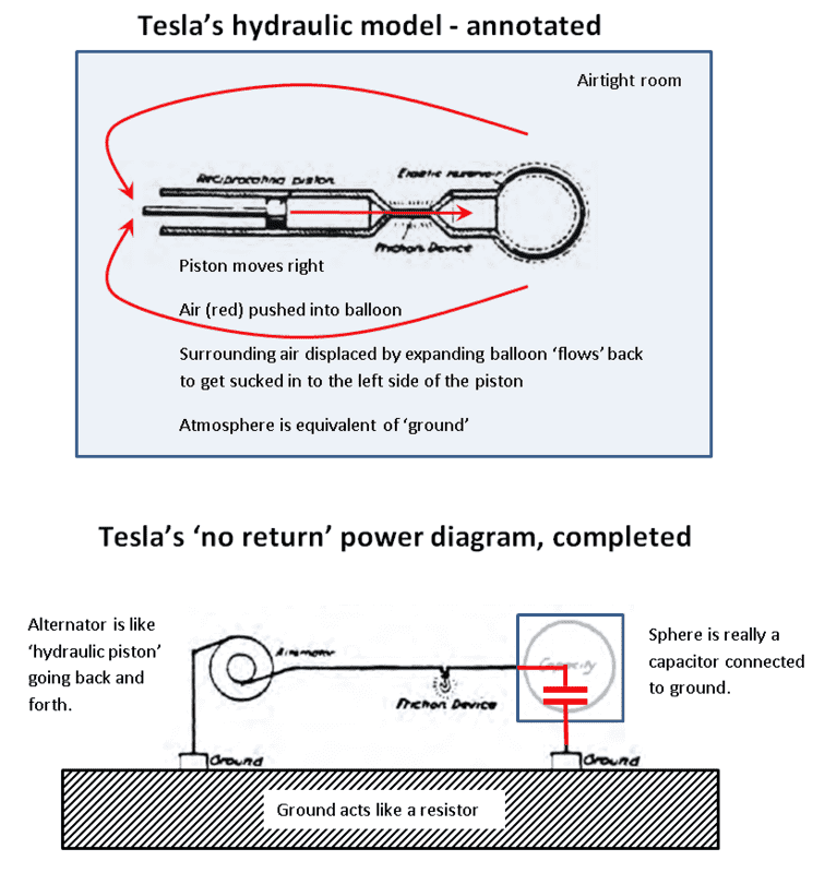

Going to investigate figure 4 from attached publication.

The attached publication has an attached conductor which is grounded you mentioned attached grounded conductors can increased capacitance. Is the attached conductor similar to what you were describing?

Looking at 'figure four', describing a system for electrical transmission through a single wire, consider the spherical 'capacity' symbol at the right side of the diagram, and think what that really represents. In the hydraulic analog, the sphere equivalent is labelled as 'elastic reservoir'. Think of this as a balloon. As the piston goes back and forth, the balloon inflates and deflates, air passing through the 'friction device' back and forth, from which energy is extracted to 'light the bulb'.
So far, so good. But there is a critical piece missing from Tesla's analogy. Take a look at the first diagram in the attached file. When the piston moves to the right, the balloon expands. But what is not mentioned is that it displaces air which replaces that sucked in behind the moving piston. There is a corresponding (small) flow of air through the atmosphere from the balloon to the piston. This is effectively a hidden return path.
Now look at the electrical diagram. The sphere is acting as a capacitor, storing and supplying energy alternately as it charges and discharges. But a capacitor has two ends and this sphere is no exception. The other end is the ‘ground’. Take a look at the second diagram in the attached file, where I have drawn in a capacitor to represent the situation more correctly. The ground itself is conductive and acts as a resistor. This is a return path, equivalent to the atmosphere in the hydraulic analogy.
Now to answer your question about having a grounded conductor near the sphere. This is equivalent to mounting the sphere close to the ground. The effect is to increase the capacitance to ground. You could get a better result by forgetting about the sphere and using a regular capacitor to ground, of a higher capacitance.
Or you might prefer simply to forget the capacitor and simply ground the sphere itself – using the direct resistive path through ground as the return without the capacitor at all.
