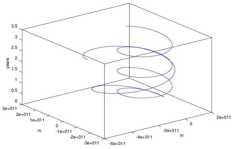

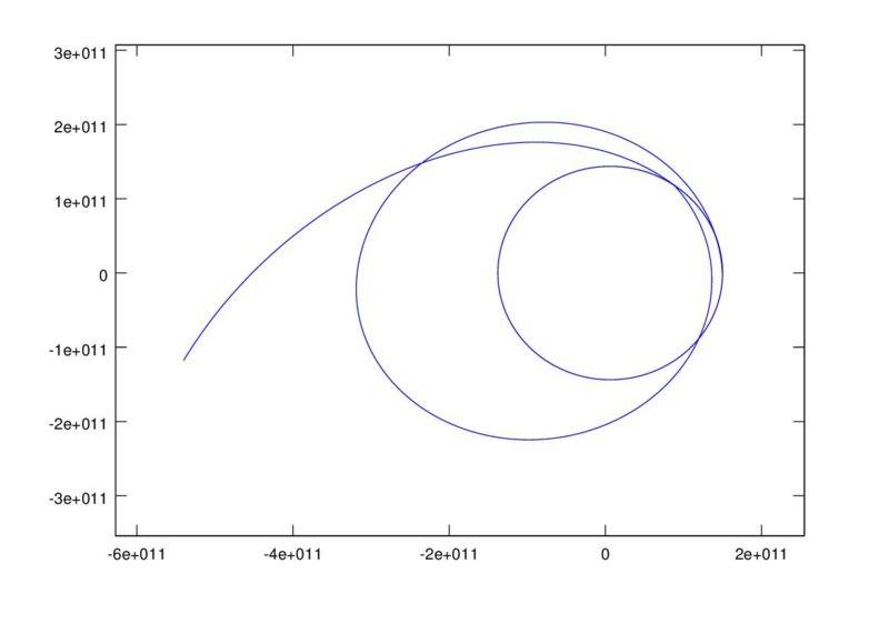

An example: the Apollo trajectory.

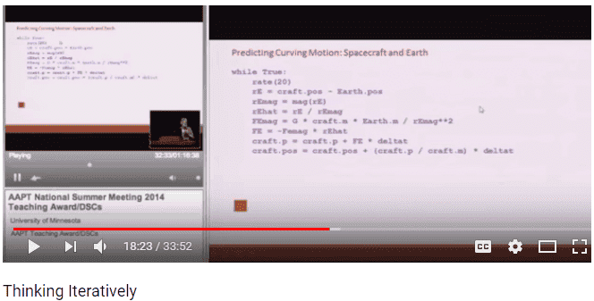

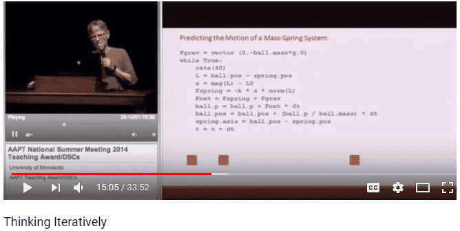

Below are screen shots from Chabay and Sherwood's "Thinking Iteratively" talk
at 15m05s:
and
at 18m23s
which could be easily modified to include an interaction from the moon (as you did) in your paper.
They do this 2 minutes later.

Apollo trajectory ... all the details are in the paper ...
getPart
Juno trajectory (MATLAB has a plot3 command) ... (essentially) same program ... launch ... 3 yr. trajectory ... 1 guidance boost about 1 year in .. rest freeflight ...
Another look at Juno
