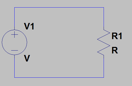

If you have a circuit which is just a power source and it looks like the following.
If the wires are just directly connected to the resistor and the circuit is floating above the ground suspended by some kind of magic.
Before we go any further, let's have a quiz, and EVERYONE IS INVITED TO ANSWER..
Question 1: What is the voltage difference between me and the return path without me touching the wire? (The return path is the wire connected to the negative terminal).
Question 2: What is the voltage difference between me and the "hot wire" without me touching the wire? (The "hot wire" is the wire connected to the positive terminal).
Question 3: What is the voltage difference between me and the return path if I am touching that wire?
Question 4: What is the voltage difference between me and the "hot wire" if I am touching that wire?
And YES I know that there are no values in the diagram, but this doesn't matter ;)
Undefined
Undefined
0V
0V
The winner is Integral :D
In the beginning, the voltages will be undefined (could be 0 volts, could be 5000 volts, could be 10.000 volts), but when we touch these wires, I get the same potential as the wire.
However, no current is running through me. So I am not being electrocuted. None of the wires are dangerous to touch. Even if the source is a staggering 100.000 volts, I can safely touch the wires.
The reason for this is of course that no current is running through me.
Current needs a loop. The circuit in the picture shown is a loop and current going out is also the current going in. If I touch either of the wires, I do not provide any path for the current, and thus, no current will flow.

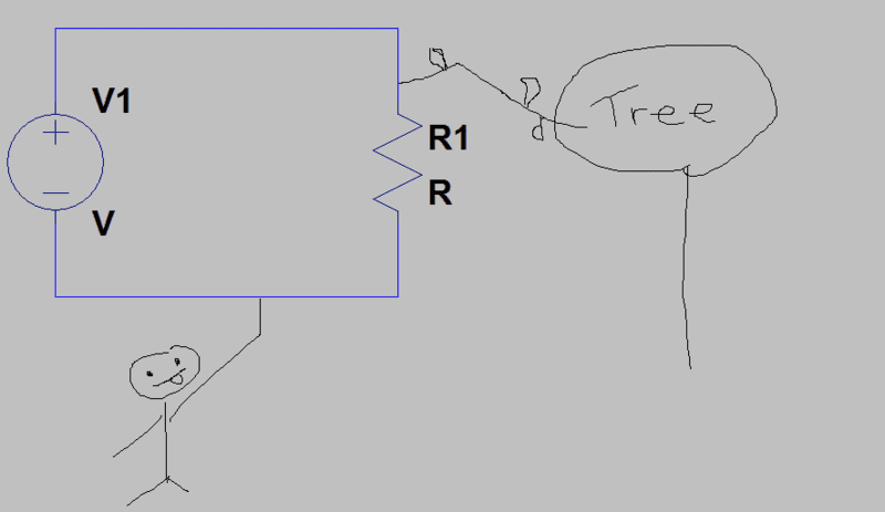

The problem happens at the instance that something unforseen comes into the picture. If this magic circuit is floating near a tree, and it so happens that one of the branches on the tree gets in contact with one of the wires, let's say the hot wire.
In this case, when I touch the return path I will suddenly have made a loop, and current will be able to flow through me.
In this case, I may be electrocuted, since a current will run through me.
How much current will run through me? Depends on my resistance. (BUT ONLY A FEW MILLIAMPS CAN KILL).
Until this point, I think most of us are following, and nothing weird has happened yet.

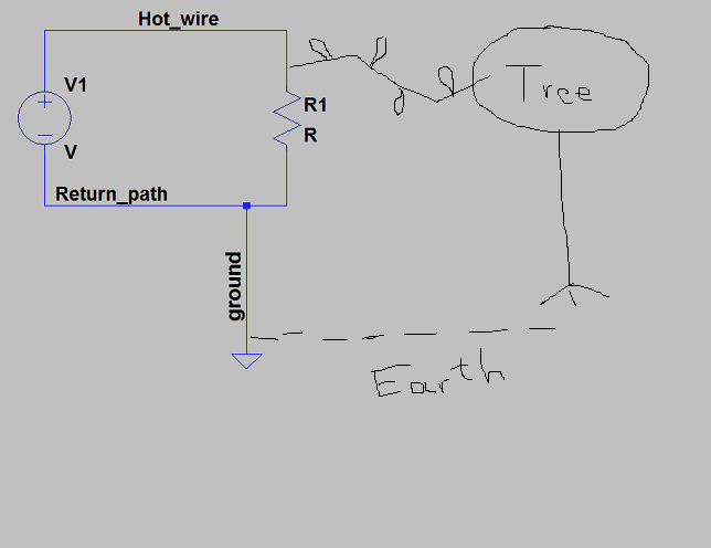

Let us now take a wire and connect to the "return path" and stick it into the ground.
The "ground" wire is an ACTUAL CONNECTION to ground now. In the beginning, no current is flowing into the ground, because there is no current loop.
But let's imagine the tree being a douche-bag again and touching the "hot wire". What happens now?
Well for one: The tree and the Earth now provide a current loop. Let's see a picture.
So if I now touch the "hot wire" also I may no longer be the easiest way for current to travel, and in this way, I am protected. However, current can still flow through me, but there is a protective device that can make you safe.
The GFI (Ground Fault Interrupter).
This piece of hardware measures the current that goes out of the positive terminal and the current that returns through the return path.
If the tree is touching the "hot wire", then there will be current through the tree and through the Earth and into the negative terminal from the ground wire. If we measure the current in the "return path" before the ground connection, then we will be able to see that not all the current going of the the positive terminal, is returning through the return path. Some of it must be going through the ground. The GFI will then disconnect the power source and we're all safe again.

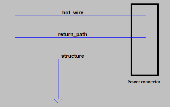

Grounding Part 3: The International Space Station
On the space station, power is generated from solar panels. In this case, we will simply consider them to be ideal voltage sources. The simplified solar array will have a "hot wire" and a "return path".
However, in order to create the correct voltages that are needed, the wires are connected to different power converters. So the voltage source shown is imagined to be the output of one of these power converters.
The return path is connected directly to the hull of the space station. The astronauts will most likely be at the same potential at the space station structure, so touching the return path of such a wire, will not give them any static shock.
Think also a moment that, if the astronaut is floating without touching anything of the space station hull, he can safely touch any of the wires.
Next step is connecting this power to some kind of equipment. For example the super gigantic death ray that they have up there, or the stargate.
The picture above shows that there are three wires in such a connector. "Hot wire", "Return" and "Structure". The structure is simply the "ground" on the space station.
When you connect some equipment to this power source, the "structure" will be connected to the "case" of the equipment. So if we're talking about the death ray, the metal surrounding the inner workings of such a thing will have the same potential as the hull of the space station. Thus, touching the case will not give you any static shock, and no current will flow through you, when you put one hand on the "case" and one hand on the hull of the space station.
IF an error happens inside the death ray, so that some "hot wire" is suddenly broken off an gets in contact with the "case" then a current will suddenly flow through the case and through the structure of the space station and back to the power source. This will make the GFI (Ground Fault Interrupter) trip and cut off power.
Of course this is a rather simplified version of what really happens in the power network up there.

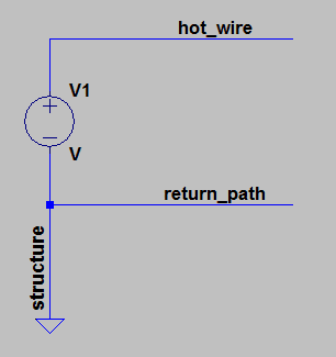

I realize I've been talking and talking and what do I really want to say? A lot of places "ground" is used in a wrong way. Most times it means the "common".
The best way to talk about power sources are in terms of a positive terminal and a negative terminal. DON'T call the negative terminal "ground", as many people do. This is simply wrong.
