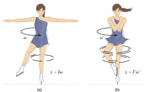

This question is about the conservation of angular momentum:
So far, I have understood the reason as to why an object with a high moment of inertia has a small angular acceleration whereas an object with a low moment of inertia has a larger angular acceleration. The reason for this is that if there are high values of r, the moment of inertia will be larger and hence a larger effort (to produce a larger torque) must be exerted. As a result, the angular acceleration of the object is small. This can be demonstrated in (a) where the change in omega/time is small
In example (b) shown above, the ballerina takes advantage of the moment of inertia by not stretching her hands out etc. and by doing so decreasing the moment of inertia and therefore a smaller torque is produced to rotate at a faster rate.
However, what I can't fathom out is; how is this related to the conservation of angular momentum which states that angular momentum is conserved unless there are external torques acting on the system.
I appreciate your comments about this and any other solutions as to why a ballerina rings in her arms and legs to spin. Thanks a lot!

For a given torque, an object with a smaller moment of inertia will have a greater angular acceleration. This is Newton's 2nd law applied to rotation.
Here there's no external torque to worry about. Since there's no torque on the ballerina, her angular momentum is conserved. If she's able to decrease her moment of inertia -- by pulling her arms in as shown in (b) -- she will increase her angular speed. But her angular momentum cannot change.

To clarify this, the image is of an ice skater in a spin. Assuming no losses or transfer of momentum to the earth, angular momentum of the skater is always preserved, but as the skater pulls her arms inwards, internal potential energy is converted into mechanical angular kinetic energy, and an internal torque increases the rate of rotation, increasing the angular kinetic energy, but the angular momentum will remain constant.

The drawing isn't intended to represent two different examples. The ice skater example is intended to illustrate how conservation of angular momentum works when transitioning between the two states.Edit: As rcgldr reminds me the following is wrong..

The angular momentum is equal between the two states, but not the KE. Internal energy is used to increase the KE from state a to state b.
Thanks. Just realized my post above was wrong. It takes effort to pull the skaters arms in so they are doing work and KE isn't constant.
