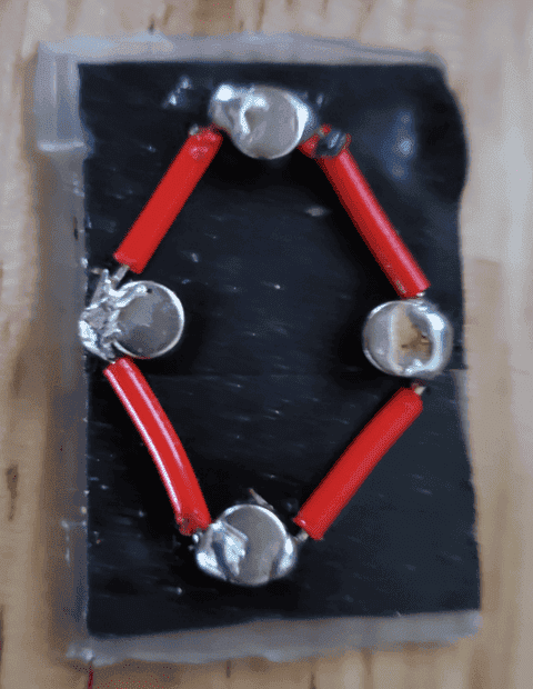

Why did my magnets lose much of their force when I soldered wires to to them?
I connected some magnets with (single strand) wire and solder in a parallelogram pattern, in the process of making a battery pack. After I was through, it seems they lost a great deal of their force, Identical magnets still attract to them, but unpolarized ferromagnetic objects (like the batteries) are no longer attracted.
Any ideas what happened? If it's simply my soldering technique or the physical arrangement I could try to come up with another one, but if it's the solder or the wires I'll have to come up with a workaround.
Picture is attached. Magnets are 5mm in diameter, wire is 22AWG, solder is leaded rosin core.
Um, why?
berkeman said:
Um, why?
I'm trying to make a (parallel) battery pack for cylindrical cells. The technique with magnets and adhesive tape was the fastest way I could come up with of correctly positioning the terminals.

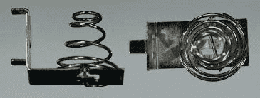

What is the exact battery configuration you want to achieve? If you want to use AA batteries (or similar standard sizes), there are lots of standard holder options. The image below show a series connection of 4xAA batteries, but you can get single holders as well, allowing you to do a parallel connection. Please do keep in mind that parallel connection of batteries should only be done with batteries that have the same history (purchased together, charged together if they are rechargeable, etc.).

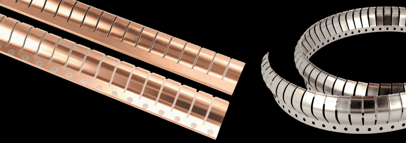

C) Could you perhaps provide a graphical example of "multiple contact points"? Most of the things I see on Amazon seem to have only one, unless a flat surface is in and of itself "multiple contacts".

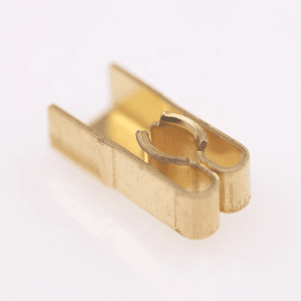

Cheap battery holders may only have one contact point for the + terminal, like in the 4xAA holder pic that I posted above. But better designed connections will use multiple contact points...
https://sc04.alicdn.com/kf/HTB1lQKCaYH1gK0jSZFwq6A7aXXac.jpg
https://encrypted-tbn0.gstatic.com/images?q=tbn:ANd9GcTpQIGWU9b7Ldo-zhtsBpIWWqK6e8_83bf-7g&usqp=CAU
https://hollandshielding.com/content/2800/2800-door-fingers-header.png

I don't think the magnet is losing its magnetization because the Curie temperature is exceeded. Solder is not all that hot.
How are the poles arranged? I suspect much of the flux is contained inside the magnets.
Likes dlgoff
Solder is certainly not that hot. The iron, OTOH, hits 320c according to the onboard sensor :).
