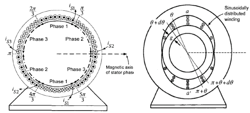

I've had this confusion too. The back EMF should be based on the winding distribution along the stator, from what I've read. See the attachment for what I'm talking about.

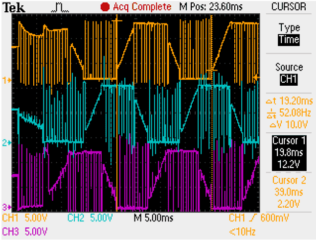

The reason I am confused is because I was using a BLDC motor before, and to determine the order of the hall magnets, I hand spun the rotor and looked at the back EMF on an oscilloscope, and I saw sinusoidal waveforms. However, when I drove the motor with a 6-step commutation, it was a trapezoidal waveform. This was a delta configuration though, so I might have missed something.
when it's driven won't terminal volts will be sum of counter-emf plus IR drop of windings ?
What did current wave look like?

These are the 3 phase's terminals as I drive it with the BLDC driver I made, which was standard 6-step commutation. The spikes are my PWM voltage control. If I disconnect the 3 phases from my driver, and spin the rotor with my hand, those 3 waveforms looked sinusoidal. I didn't measure the current waveforms unfortunately.

looks like each phase enjoys an "off" period between high and low time.
Are your traces each phase to common?
Would that mean the phases themselves(you said they're delta) get the difference between your voltage traces?, ie ab feels top minus middle, bc feels middle minus bottom, etc ?
Can you acquisition system display that?
ESIT - NOw i don't know what's going on either, just thinking along with you,
But remember a square wave voltage applied to a pure inductor results in triangle wave current
di/dt = constant
maybe that has something to do with it.

This was last summer, so I don't remember all the details, but I am pretty sure that all traces are with respect to common ground because the oscilloscope I used internally connects all of the probes references together.
The last part you said makes a lot of sense, and I remember thinking that the back EMF must be dependent on the signal the motor is driven with, but in the literature I was reading, they said that the trapezoidal back EMF is determined by the winding distribution. If that is the case, then that must be an independent factor that determines the EMF, even though when I measured it like I described, I saw sinusoidal phases. That contradiction is what confuses me and probably the OP too.

One thing I have remembered since I first explained my confusion is that when I measured the back EMF by rotating the rotor with my hand, I was looking at the EMF between 2 phases, and this was sinusoidal. When I measured the back EMF as in the waveform, this was done with respect to common ground.
it takes careful attention to make a good sine wave.
Recall your flux wave has to be cosine shaped. That won't happen by accident.
