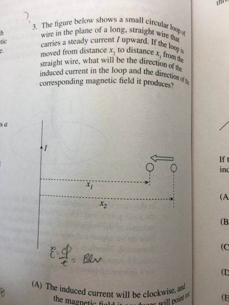

The figure below shows a small circular loop of wire in the plane of a long, straight wire that carries a steady current I upward. If the loop is moved from distance x_2 to distance x_1 from the straight wire, what will be the direction of the induced current in the loop and the direction of the corresponding magnetic field it produces?
right hand rule?
I am at a total loss as to how to solve this problem (unfortunately, I'm not familiar with the concept to begin with)... I was thinking the right hand rules might help me, but both #1 and #2 rules don't seem to be much of help. I also know that E=Blv, but otherwise I am very stuck... Please help!

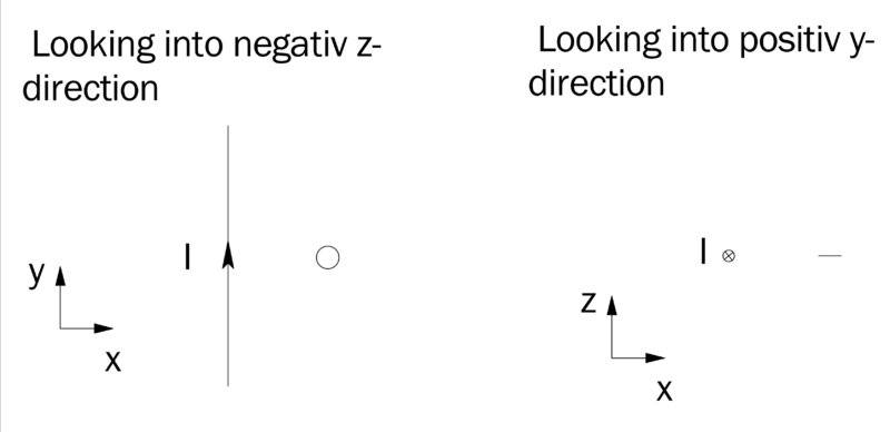

Unfortunately you are. I attached a small schemtic with an coordinate system. On the left-hand side there is the original situation from your textbook, we are looking on the xy-plane (in neg. z-direction). If we flip the picture to look on the xz-plane (pos. y-direction), we are looking along the straight wire in current direction (which is marked with an x to see that the current is conducted away from us). The samll circuit from this perspective looks like a line.
How would the magnetic field generated by the current in the straight wire look like in the second perspective (xz-plane)?

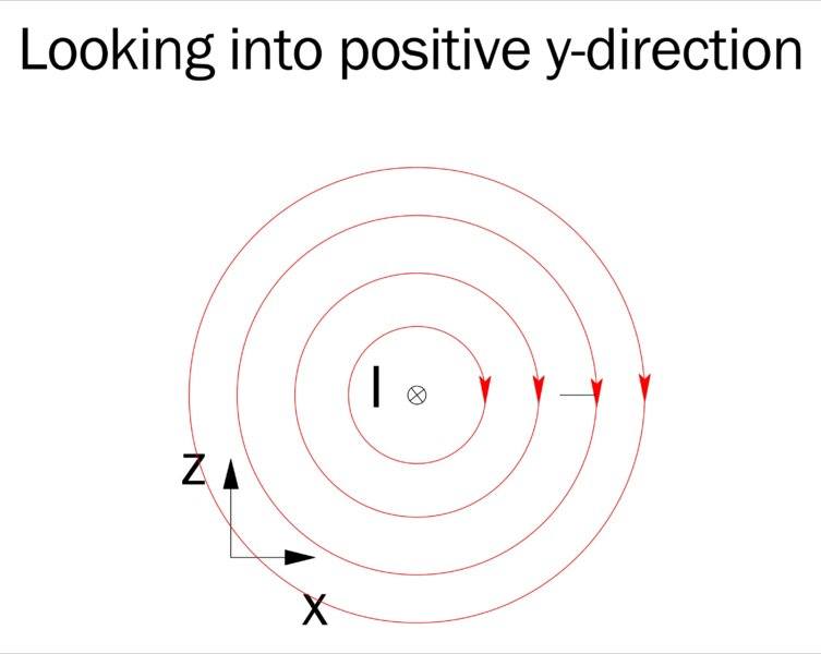

The field is clockwise with respect to the direction of the current ##I##. You have to position yourself to look in the flow direction of the current (like in the picture on the right-hand side) and then you can draw concentric circles around the wire (red in attachment) - that's the shape of the magnetic field. And it gets weaker with increasing distance from the wire.
From the textbook image's point of view the field lines look like lines (like the small circuit in the right-hand side view).
JessicaHelena said:
It'd also point out of the page then? But doesn't the field already point out of the page in the original example as well?
So, the direction of magnetic field is indicated by the field lines with the red arrows. If you change to textbook view again: Are they pointing in or out?
