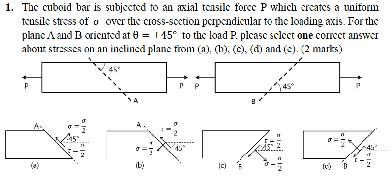

The directions of normal and shear stress

I view it like A and C are the same; B and D are the same...
as both shear stress of A and C points outwards and shear stress point to the corner with 135 deg
vice versa for B and D
what should I notice from this problem and what theorem can I apply to it so that I can distinguish the correct answer?
thank you

Is there a choice "e" as stated in the problem, but which doesn't show on your image?
E is to draw the correct answer by yourself
But the problem doesn't say that. Why do you say that?
Newton’s second law.
Oh I think I understand. Image (e) is just a blank that asks you to draw in the correct diagram. Well since (a), (b), (c), and (d) may be incorrect, it is best to get out your pencil and paper and start drawing up (e). Draw free body diagrams of either plane A or B, using Newton's laws, and utilize your knowledge of vectors and vector components acting normal and perpendicular to the inclined section.
