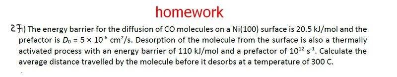

The distance traveled by a molecule at a specific temperature

In the homework, I am supposed to know the average distance traveled by the given molecule (see the attached image for the full exercice)

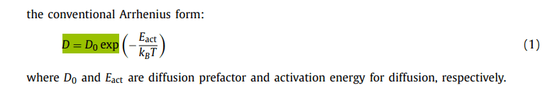

I've found one equation not sure if it is the one I should use. ( it's in the second image attached)
I found this equation:
and kB and T are Boltzmann constant and temperature, respectively.
The mean free path is irrelevant, as that refers to the gas phase, and we are talking about the diffusion of CO molecules on a nickel surface. Presumably the CO molecules are loosely bound to Ni atoms, and the process involves jumping from one Ni atom to a neighbour, so you need to know the rate of jumping, and how far apart the Ni atoms are on a (100) surface. You also need to know the rate of desorption.

Sorry I modefied everything! I found another equation, other than the free path one, what do you think?

Yes, the Arrhenius equation is what you want. Actually, thinking about it, perhaps you don't need the Ni atom spacing after all, as D is a diffusion constant rather than a rate constant.

But I don't know, how can I use this to calculate that average distance? I don't understand how it is related to the Arrhenius equation and the diffusion constant.
As this physics part is entirely new to me, I would appreciate it if I get an answer from you about that.
If it is entirely new, why are you being given homework questions on it? What have you learned?
Hmm.. doesn't seem as obvious as I first thought. Bulk diffusion rate depends on the concentration gradient, which you have no information about. If the concentration is uniform, there is no net diffusion, but individual molecules are still moving around. The diffusion coefficient can be related to molecular properties e.g. in the kinetic theory of gases, but gas diffusion is not an Arrhenius process like this. I suppose the diffusion coefficient could be related to the rate of molecular jumping, as mentioned in my first post, but that seems a bit much for a homework question - unless it's something you're supposed to have studied.
