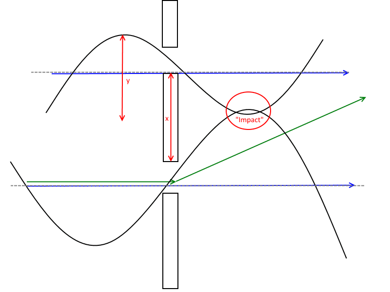

I get that the waves influence each other but I don't get my mind around why. If the two beams go straight through the slits their amplitue (y) has to be somewhere in the dimension of the distance between the slits (x) so that an "impact" or distorcion could take place.
Or is it like I tried to show with the green line that the light changes direction while passing the slit?

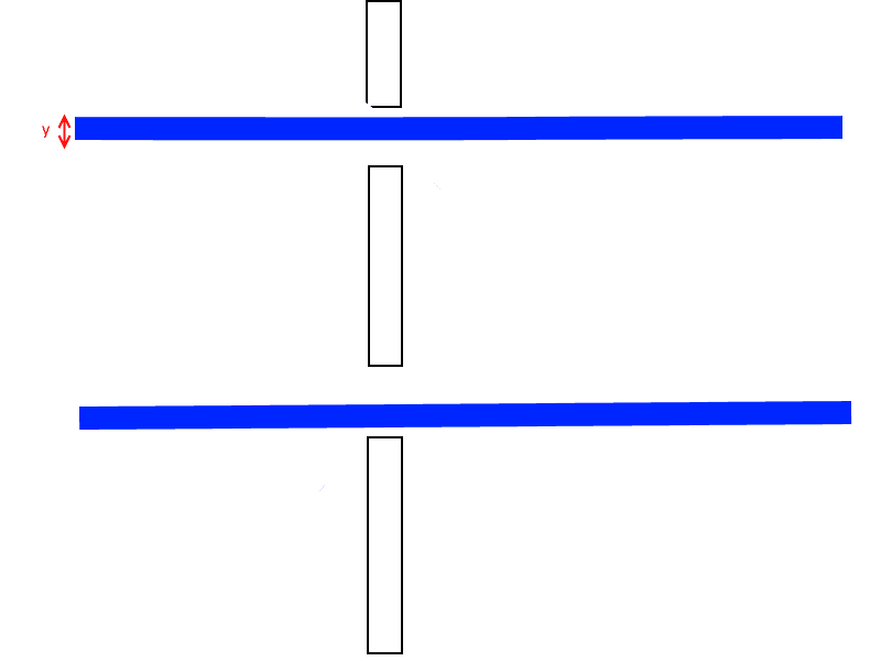

This image should be more acurate but if it is I don't get why the two beams influence each other. (y again is the amplitude of the lightwave.)
CapsE said:
My question is: How big is the amplitude of light meaning the distance from the negative to the positive peak in millimeter (or any other unit of length).
That amplitude is not a distance at all. Those pictures that show wavy lines are graphs, with the strength of the electric field on the vertical axis and time on the horizontal axis. They show the strength of the field over time at a single point.
Likes 1 person
They can also be interpreted as showing a "snapshot" of the strength of the electric field versus position at a single instant (point in time), along a line in the direction that the wave is propagating.
