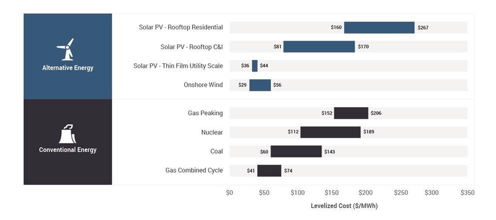

The price of natural gas in the US is about 1/3 the 2006 price and solar and wind are now competitive. Here is a current analysis (in $/MWH)
The cost of nuclear does not really matter, as it cannot be financed under the current political climate
https://www.lazard.com/media/450337/lazard-levelized-cost-of-energy-version-110.pdf

The chart shown above (@BWV) shows higher costs than I would have expected -- my electric bill shows 9 cents/KW-hour (that's the per KW rate, not including the various taxes and $15/month service fee). So, $90 per MW-hour at my house (ie, includes both generation and transmission/distribution).

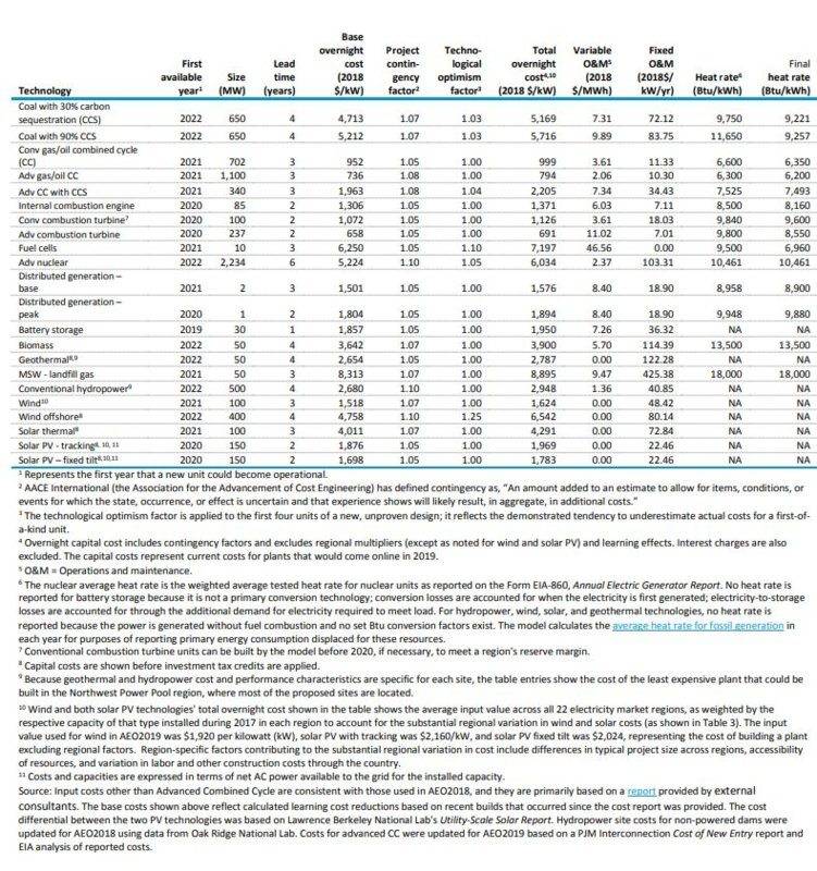

So $90/MW-hour vs some mix of combined cycle gas, wind and utility solar (which is the new electric generation triumvirate) works
Also $90/MW-hour vs marginal cost of coal and nuclear presumably works (as these plants are old and fully depreciated). These numbers include capital costs and do not reflect the marginal cost of continuing to operate an plant

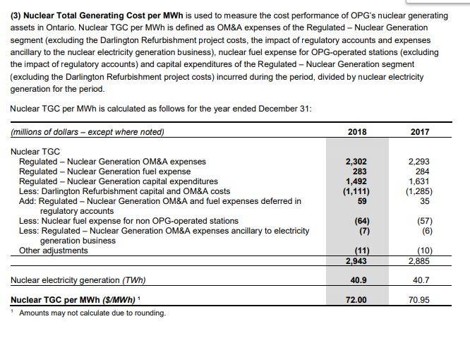

Dont see that, this is the breakdown in Darlingtons Annual Report, no depreciation is listed and the capital costs of the recent refurbishment are netted out of the $70 CAD number. If you look at the history, it cost $14B CAD to build and took a decade from breaking ground to beginning operations.
https://www.opg.com/document/2018-annual-report-2/

I am not against nukes, but look at the numbers I posted , the $72 CAD per Mwh from Darlington's annual report does not include any capital costs. The graph in #11 shows the last nuclear plants built in the US cost $8-9K per Kwh (in 2010$), so without regulatory reform, no nuclear plants are going to be built
BWV said:
Dont see that,
It is listed in the table as "Nuclear Generation Capital Expenditures". That is not the entire investment, it is interest plus this year's share of the investment which we call depreciation.

No "Nuclear Generation Capital Expenditures" is actual capex incurred during the year, not depreciation of past investment or the financing costs - just look at the income statement. Nothing in that number reflects the $14B CAD cost of building the plant.

This is GAAP reporting, not income tax - income tax depreciation schedules are different from GAAP depreciation, which attempts to reflect economic reality. The value of the plant can be depreciated to zero on a GAAP or tax basis, but incremental capex (like the refurbishment listed in the schedule) adds to the capital value, so in practice this is unlikely. The depreciation schedule in the Annual report goes out as far as 74 years for nuclear stations (this is Ontario Power Generation's report, so it includes multiple stations)
