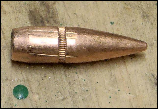

the bullet design is like the one on the left.

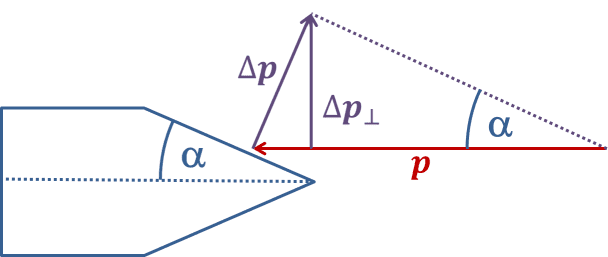

If the collision between the bullet and the raindrop is asymmetric, it can deflect the bullet - water is pushed away at one side, but not (or less) at the other side. The motion of the water is negligible.
I don't have values for those bullets, but here is a quick check: Approximating the rain drop as cube, 10mm^2 contact area, 3mm thickness (in flight direction), and 20 degree contact angle (only determined by the shape of the bullet). Let's assume that just one side of the bullet hits the water. 10g mass of the bullet, which has a velocity of v.
The displaced water has a mass of 30mg, and gets a velocity of sin(20°)v=0.34v. The bullet gets a velocity component of 30mg*0.34v / (10g)=0.0010v orthogonal to its direction of motion. After 110m (~350 yards), this gives a deflection of 11cm (~4 inch).
Not so far away from the experimental value, so it might be possible. You can replace my guessed values with more realistic values if you like.
The reduced horizontal component leads to a slightly longer flight time, this can give an additional deflection (always downwards).
This is the bullet.
.308 inches in diameter, 1.125 inches long, 150 grains, (there are 7000 grains in a pound.)
It has a ballistic coefficient of .398.

If the drop hits one half of the tip-cone, it will be sprayed in a 180° arc laterally. Compared to single object (of the same mass as the drop) deflected laterally this means less net lateral momentum transfer (because some of it cancels), but it is still the same order of magnitude.
A.T. said:
What matters is the mass ratio, not the momentum ratio.
To elaborate further on this:
In the rest frame of the bullet the obstacle has the momentum [itex]p[/itex]. [itex]\Delta p[/itex] is the minimal change in momentum to move it out of the way. [itex]\Delta p[/itex] just removes the obstacle's momentum perpendicular to the cone surface. The obstacle doesn't bounce off, just slides along the cone outwards after impact. [itex]\Delta p_{\perp}[/itex] is the lateral component of [itex]\Delta p [/itex].
[itex]\Delta p_{\perp}=cos \alpha \cdot sin \alpha \cdot p[/itex]
[itex]\Delta v_{\perp bullet}m_{bullet}=cos \alpha \cdot sin \alpha \cdot v_{bullet}m_{obstacle} [/itex]
[itex]atan \beta = \frac{\Delta v_{\perp bullet}}{ v_{bullet}} = cos \alpha \cdot sin \alpha \cdot \frac{m_{obstacle}}{m_{bullet}}[/itex]
Where [itex]\beta[/itex] is the deflection angle, which depends only on the mass ratio and shape. For [itex] \alpha = 45°[/itex] and the mass ratio 1/100 you get [itex]\beta=0.3°[/itex] or 0.5m offset after 100m.
Obviously a water drop will be sprayed in different lateral directions, reducing the lateral deflection. On the other hand we assume a perfectly inelastic collision, where the water just flows along the cone. If the water bounces off [itex]\Delta p [/itex] and thus the deflection will increase.

Andrew Mason said:
force of 12 Newtons. I would be interested in knowing how the raindrop can exert that amount of lateral force on the bullet.
Talking about forces here doesn't offer much intuition, because for such short impacts they are always large. Do your calculation for a 0.1g drop, that hits a wall vertically at 610m/s. The deceleration time is the diameter divided by the speed. What is the average force there? The lateral force on the bullet is some fraction of this, depending on the shape and the impacted area.
AT, those calculations make sense, but I think you overestimate the effect by only considering momentum in the plane of the two centres of mass- for a mass ratio of 1/100 you need a pretty huge raindrop, and you're assuming that the entire mass of this raindrop will be diverted with upwards momentum along the side of the bullet.
This is only strictly true for the water which lies in the plane- a lot will be deflected outwards of the paper/screen, and the same amount will be deflected inwards towards the screen. Although these two z-direction impulses cancel, you are counting them in your calculation.
Furthermore, the bullet angle you use is only 45 degrees at one radial point, and that point might be a tiny fraction- if you average the angle with respect to the bullet's radius (ie. proportionate to where the raindrop might impact) I think the effective angle will be much smaller, as they tend to narrow to a single point at the top rather than a perfect hemisphere. Some of the water will be deflected more, but I think most of it will be deflected far less than along a 45 degree slope.
If your mass ratio is 1/100 then assuming the bullet weight is about 5 g, the raindrop radius must be about 2.5 mm, whereas the bullet radius is about 3.8 mm. They're pretty similar in size and that makes me think this overestimate is quite big.
  • #31
Yes I mentioned the spraying.
45° was just an example. Also note that we assume perfectly inelastic collision. If the water bounces off then the effective angle is different from the shape of the bullet.
That is a good point. I think most of the effect could come from destablisation/precession, rather than from direct momentum transfer. But that is even more difficult to estimate.

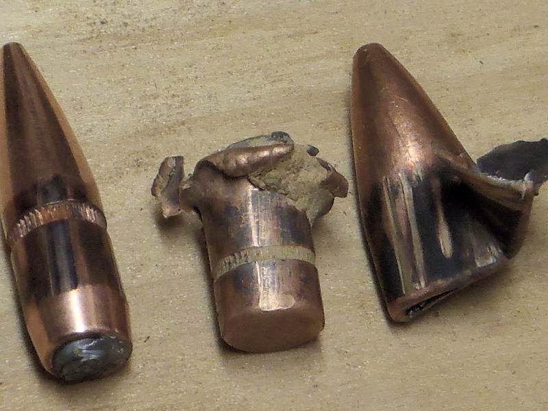

I expect the physics would be complicated to analyse accurately. The American Rifleman article that I referred to earlier shows the results of an experiment firing rifle bullets at wood dowels at 25 yards and observing the bullet orientation and path over the ensuing 75 yards using 32 paper screens. The paths of the bullets was spiral, a consequence of the loss of stability rather than lateral momentum imparted by the contact with the dowel. Some of the tests involved striking just the edge of the dowel (see Fig. 9 from the article). This caused a deflection of about 9 inches over 75 yards.
I just can't see a single raindrop having nearly as much effect as a hardwood dowel.

I don't see how figure 9 corresponds to an asymmetric hit. At that speed, wood and water are not so different, if their area density is similar.
