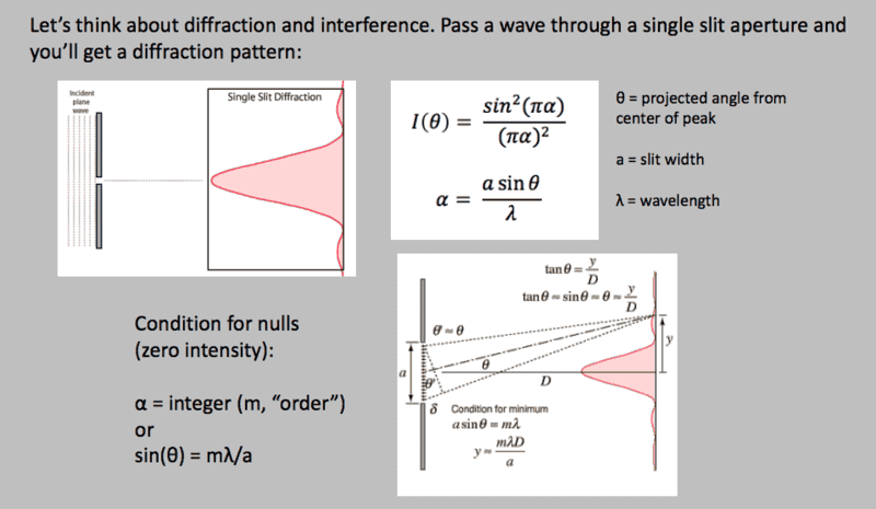

As you mentioned that a slit width b will introduce Δθ=b/f, can you provide me any schematic of the same how the angle is being calculated ? Like, I have searched many optical articles regarding it which is showing a incident ray and a reflected ray with the angles and planes with a separation of d, but I am unable to relate the slit width b, the focal length f and Δθ. I would really appreciate if you can show me how the angle is formed with b and f, or explain or upload any image. i have uploaded an image similar to it.
Best Regards,
Avra
I couldn't find a good diagram either, but this is something that is used frequently in optics. Parallel rays coming in at angle ## \theta ## onto a focusing lens or mirror will focus in the focal plane at height ## h= f \,\theta ##. This should be somewhat obvious because if the rays are parallel, it means the source is far away. Using the lensmakers formula ## \frac{1}{f}=\frac{1}{s}+\frac{1}{m} ##, for object distance ## s =+\infty ##, image distance ##m= f ##. This means the parallel incident rays at angle ## \theta ## will converge and come to a focus in the focal plane. The ray through the middle of the lens goes straight through, so that the height is ## h=f \tan{\theta}= f \, \theta ## for small angles ## \theta ##. ## \\ ## Taking the rays in reverse, with the source on the focal plane, if the rays start at height ## h ##, they will come out parallel at angle ## \theta=\frac{h}{f} ##.
