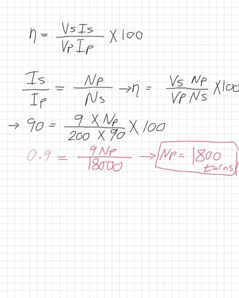

A step-down transformer has an efficiency of 90%, the voltage of it primary coil is 200V and its current is 0.5A, and its secondary coil has a voltage of 9V and a current of 10A and its number of turns is 90 turns.
Calculate the number of turns of the primary coil.
η =VsIs/VpIp * 100
Vs/Vp = Ns/Np
Is/Ip = Np/Ns
I solved the problem in two slightly different methods, the first one:
And the second one:
The solution in the first method (Np = 1800) is the correct one, but I don't understand why the second one is wrong. I thought that both will lead me to the same answer, but apparently they didn't, could you explain it for me, please?
The transformer is not ideal.
Hence,

OK, but why (Is/Ip = Np/Ns) is true?
It is because of the mmf balance in the core. (Magetizing current is neglected as it is very small compared to the load current).

I didn't know about the MMF balance in my textbook, but I googled it and understood it. Many thanks!:smile:
