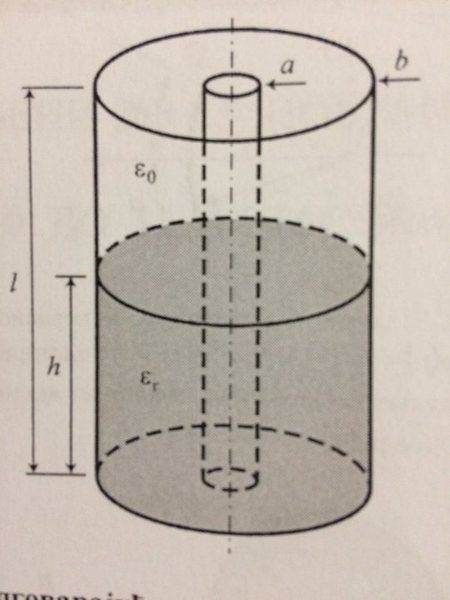

1. The problem stsatemesnt, all variables and given/known data
A cylinder conductor of length ##l##, inner radius ##a## and outer radius ##b## is half-filled with a liquid dielectric as shown in the picture. The cylinder is attached to a battery of constant voltage ##U## and then separated from it. Imagine that the dielectric is leaking and calculate the change of electrical energy when there is no dielectric present. ( meaning the difference between the beginning state and the one were there is no dielectric)
There is a picture below.
3. The Attempt at a Solution
I'm going to guide you through my work and thinking so you can correct me and help me finish the problem.[/B]
##ΔW_e=W_{e2}-W_{e1}## ( The state 2 is when its empty)
##W_{e1}=\frac{1}{2}\frac{Q_1^2}{C_1}## ( ##C_1,Q_1## are the total charge and capacitance of the system 1)
Because there is a dielectric in the first system i have two electric fields, the one above the ##h## and the one below going radial.
##E_1=\frac{Q'_1}{2 \pi ε_0 r}##
##U_1=\frac{Q'_1}{2 \pi ε_0}\ln (b/a)##
##E_2=\frac{Q'_2}{2 \pi ε_0 ε_r r}##
##U_2=\frac{Q'_2}{2 \pi ε_0 ε_r} \ln (b/a)##
Then i express the linear charge densities ##Q'_1,Q'_2##
##Q'_1=\frac{2 \pi ε_0 U_1}{\ln (b/a)}##
##Q'_2=\frac{2 \pi ε_0 ε_r U_2}{\ln (b/a)}##
##Q_{total}=Q'_1*(l/2) + Q'_2*(l/2)##
Something does not seem right here, can you help me with what i got wrong?

It's not stated but I am guessing that ##Q## must be conserved and ##C## and ##U## are changing. :) The whole work is my guess so i don't know the answer if anything is conserved xD I was thinking someone can provide an insight.
I would forget about E fields. Just compute C1 and C2, then take the difference in 1/2 CV^2. Yes, Q is conserved; removing the dielectric does not remove any charge. So you know that V1 and V2 will be different also.

OK take two large parallel plates. Area = A, separation = d. What's the capacitance?

For the cylindrical system i then have two capacitances ##C_1=\frac{2\pi\epsilon_0L/2}{ln(b/a)}##, ##C_2=\frac{2\pi\epsilon_0\epsilon_rL/2}{ln(b/a)}## Now i need to know the ##V_1,V_2## for the system in case it's half filled and for that i need ##E##. When i find that what is my ##C## for the case where its half filled? I have two C's?

You don't need E.
You have two capacitors in "parallel", do you see that? Call them CA and CB. So C = CA + CB. Say CA has the dielectric, initially. You can compute CA1; also CB1 = CA2 = CB2.
You know V1, = same for CA and CB. You then can find Q = V1(CA1 + CB1).
For V2 you invoke the fact that Q does not change. This enables you to compute V2.
Finally, as I said, energy = 1/2 Δ{CV2}, or = 1/2 Q ΔV.

No guessing. Physics. Where would Q go ?
