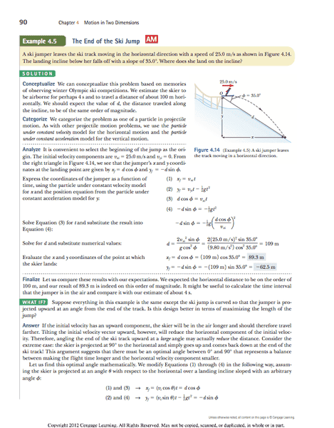

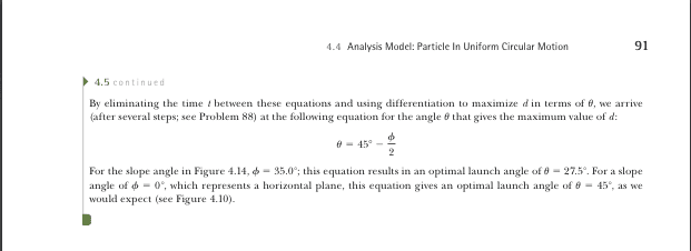

A ski jumper leaves the ski track moving in the horizontal direction with a speed of 25.0 m/s as shown in Figure 4.14. The landing incline below her falls off with a slope of 35.0°. Where does she land on the incline? I've attached an image of the problem, my work is below it.
xf = (Vicos(theta))t = dcos(phi)
yf = (Visin(theta)t) - (0.5)gt^2 = -dsin(phi)
I understand and reached the solution of part a), but I am struggling with part b). It says to eliminate time "t" and differentiate and maximize "d" in terms of angle "theta".
this is the furthest I've gotten:
t = xf/(Vicos(theta))
yf = (Visin(theta))t - (0.5)gt^2
plugging in t = xf/(Vicos(theta))
yf = (Visin(theta))(xf/(Vicos(theta)) - (0.5)g(xf/(Vicos(theta))^2
= xftan(theta) - (0.5)g(xf/(vicos(theta))^2
= xftan(theta) - xf^2(1/(2gVi^2cos^2(theta))
(factoring out and dividing by xf)
yf/xf = tan(theta) - xf/(2gVi^2cos^2(theta))
-dsin(phi)/(dcos(phi)) = tan(theta) - xf/(2gVi^2cos^2(theta))
-tan(phi) = tan(theta) - xf/(2gVi^2cos^2(theta))
I don't know what to do after this step. Any help would be greatly appreciated. Thank you!

Check that step. The second line is dimensionally inconsistent.
(This is a useful technique for finding algebraic errors in physics. Check whether the final equation makes sense dimensionally. If it doesn't, do a 'binary chop' to see where it went wrong.)

Say you did eight operations on an equation in sequence. The first equation passes some check (such as dimensional consistency) but the ninth doesn't. so check the one in the middle. If that's ok, check the one half way from there to the end, etc.
